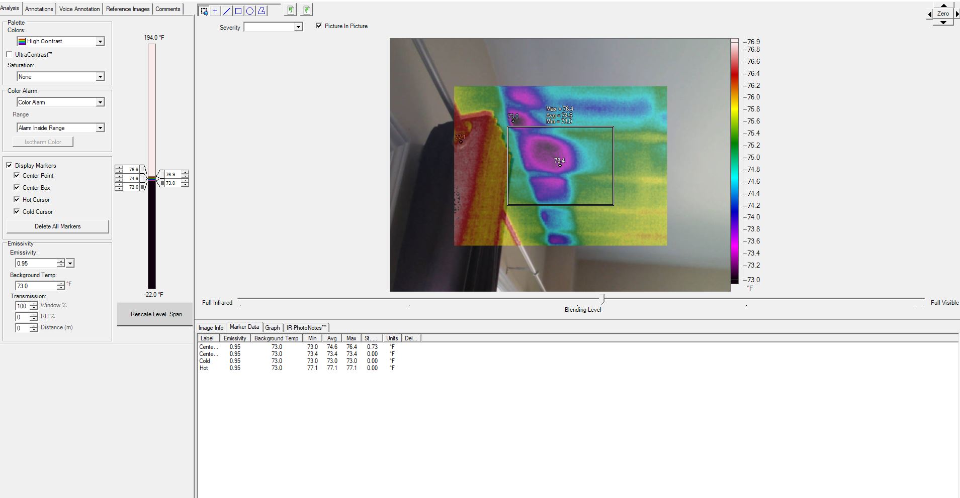

Here’s one from earlier this week. I had a heads-up from the buyer as he had noticed a repair spot under the upstairs Master bath area. The seller had said it was from a tub overflow, but the buyer had his doubts.
I let the tub run a bit longer than normal and viewed the ceiling beneath about an hour later, revealing a small area cooler than the surrounding ceiling. Readings from my pen-type moisture meter indicated moisture levels twice that of the surrounding area. Because of the location, I said I was fairly certain that there was a leak at the bathtub drain.
I include a picture-in-picture photo for simplicity’s sake. The ceiling showed no discoloration or other visible sign of moisture.
I can’t imagine how I would have been able to find this without an IR camera.

2013 constructed 2.5 story home.
Inspection. 3 days ago.
EIFS inspection. PB EIFS.
Building had 3 veneers. Masonry, EIFS, Vinyl siding.
Siding did not impede energy transfer as well as masonry and EIFS.
2 blended Images: 55% & 90% blending.
Location: Main landing. Rear left room.
HYPOTHESES: Energy transfer.
Energy loss at the joist bays.
IMO this is a critical intersection for energy loss and cheap to improve.
Weather. Clear skies.
Exterior 81° Fahrenheit @ 51% RH.
Interior >< 75° Fahrenheit @ 47% RH.
The drywall is colder because the second level floor joist bays where not insulated properly close to the wall.
(William B. Ogletree, TREC License #22530) #28
Good stuff, Robert, thanks!
I have to admit, I’m having a little trouble making sense of what I think I am seeing. With outdoor ambient temps at 81 F and indoor at 75 F (less, I have been taught, than is necessary for accurate evaluation of temperature differentials), what is causing the cooling of the drywall? I could not be loss of heat to the exterior due to the higher external temps, so is it conditioned air from the second story, or some other source that I am not thinking of?
Also, how would you suggest this could be corrected?

Hypothesis: HVAC ductwork supply, flex duct, between the floor joist and band joist. There are issues with the ducting. Or at least that is how it appears to me.
You can see the joists have been bridged with furring for the ceiling drywall. Very common in rural settings in my neck of the woods.
Condition: Compromised ductwork. The owner complained about low air flow to the second floor. Circular ceiling ducts in the mother apartment in the basement were closed and the space was cool. Cooling to the second floor was minimal. 2.5 ton equipment. Could maker snow if I lowered the temp:)

Exterior = 59% RH @ 81° F
Interior = 45% RH @ 75° F
Cladding. Outer wall Vinyl Siding. Inner wall. Tentest overlay. Insulated 2" X 4" Stud bays.
2 images. Same interior location. Main level. Rear/West wall.
1: >90% visual / IR blended.
2: ><55% visual / IR blended.
Infrared Thermal Equipment . Ti300 60hz camera.
Emissivity table: (95)
Pallet Color: Iron Bow. Normal contrast.
Background temp set at 73 ° F
Level/Span, Auto.
IR Window: 100%
Observation: A semi continuous width, approximately ><18" wide, of deep blue bordered by an aqua blue hue.
Location: Second level outermost floor joists. Main level. West wall.
Conclusion. Energy loss. Insufficient thermal barrier for the flex duct.
Hypothesis: Flex duct was not evenly insulated. The HVAC installer used loose cellulose fill to surround the flex ductwork between floor joists and wall chases.
Conclusion: A denser type insulation would decrease energy loss at this location.
