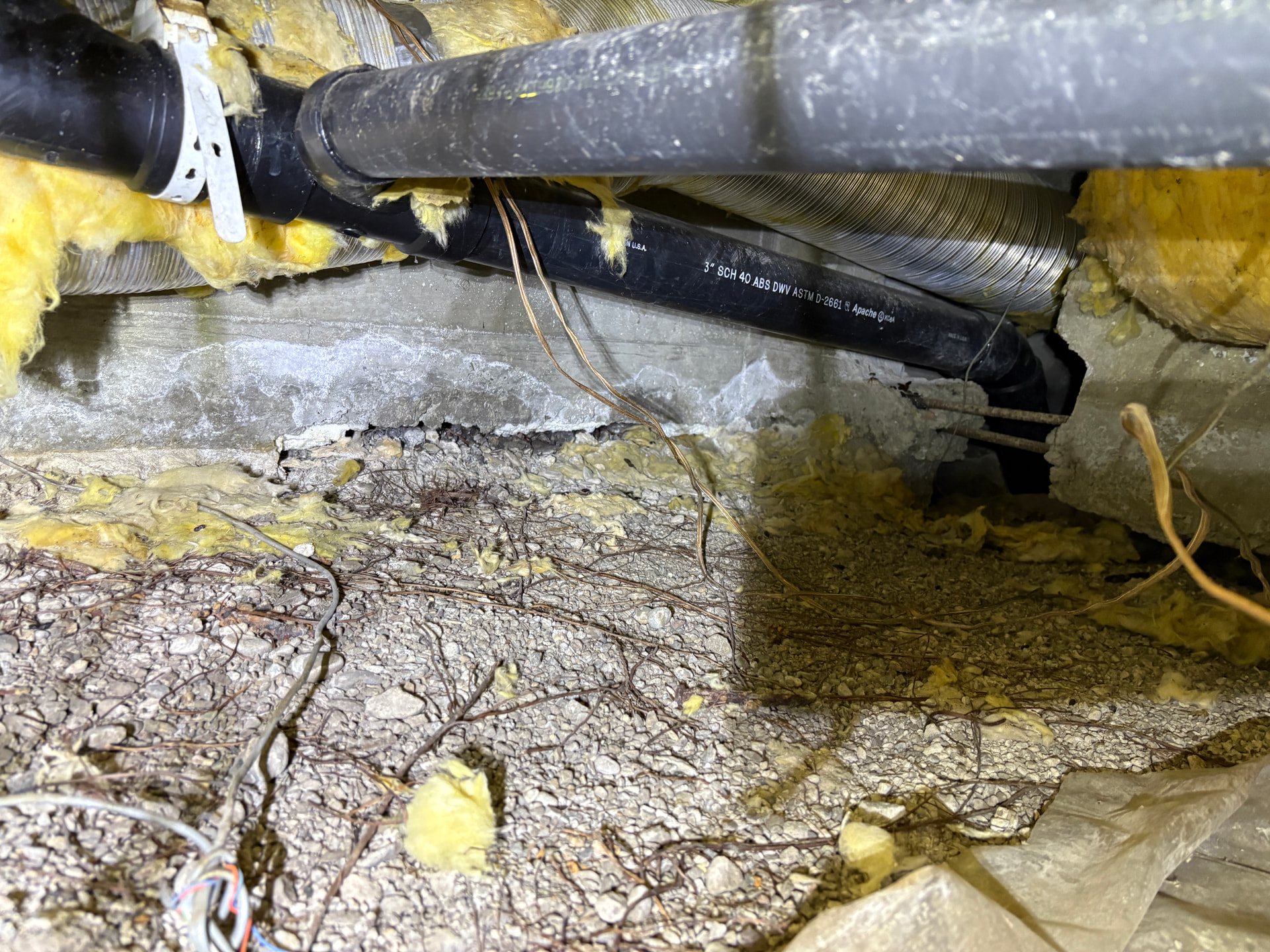

Hi Friends
I inspected a crawlspace and found a section of foundation was broken down in order for duct pipe and sewer pipe to go through. Also the bottom of the foundation was suspended, there is a gap from the dirt floor. I’d like to pick your brain on this issues. ray bars exposed, I think this is a major defect.
Thanks
Caleb

Hi Caleb, This is what you sent me in the PM: (You can upload here like you did for the PM.)
 ![0000](https://global.discourse-cdn.com/internachi/original/4X/4/f/d/4fdfd2688d8ef17b76d4da0a524f69aea0f88500.jpeg)
I’m afraid it doesn’t tell much.
Do you have additional pictures that capture the floor joists, any beams, columns, etc….you know from farther back to get an overall sense of the situation?

Hi Matt
Here is the picture. Thank you for your help in advance.
 ![IMG_7516](https://global.discourse-cdn.com/internachi/original/4X/c/f/a/cfa896d6de12386cb73e345969fa569b51d3bb3d.jpeg)

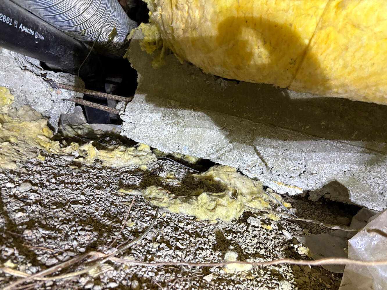

**Author:** ![czhang7](https://sea2.discourse-cdn.com/internachi/user_avatar/forum.nachi.org/czhang7/32/255253_2.png) [@czhang7](https://forum.nachi.org/u/czhang7)\
**Post date:** [November 7, 2025, 10:51pm UTC](https://forum.nachi.org/t/foundation-break-through/262031/8 "2025-11-07T22:51:38Z")
</div>
![IMG_7515](https://global.discourse-cdn.com/internachi/original/4X/a/8/d/a8d6505319fe55e8a523100e186a2887f57f6a7d.jpeg)
 ![IMG_7512](https://global.discourse-cdn.com/internachi/original/4X/e/f/9/ef9e1ee3ba81be4357e38799a34a3e22b6bff95b.jpeg)
 ![IMG_7513](https://global.discourse-cdn.com/internachi/original/4X/a/9/8/a98a2b6f4e332fca22d5b323dfcb04de36c5db4e.jpeg)
 ![IMG_7514](https://global.discourse-cdn.com/internachi/original/4X/5/3/8/538a272364c66beb864645624ffcfb43f3fefd8d.jpeg)

If it was just the opening in the foundation wall probably not a huge deal.
BUT, when accompanied with the undermined bearing foundation walls, I would refer it out to a qualified foundation contractor/structural engineer.

Hi Kevin
I don’t see signs of water under the suspended part of the foundation, it seems like the foundation modified for the ducts and pipes not for addition but for “convenience” so the ducts and pipe can go through to the other end of the house. See the photos
 ![IMG_7517](https://global.discourse-cdn.com/internachi/original/4X/9/4/1/9419cfdd39a4389463ae50fe10a3dbdbea598534.jpeg)

The ray bars were exposed, isn’t that a indication of load bearing foundation wall? I am not sure why it was done this way, the home owner lived in this house for 20 years and never went into the crawlspace nor did any additional work, the pvc black pipe and aluminum duct look original. What would you do in reporting it?

> [@czhang7](#):
Don’t make it more complicated than it is.
Report what you see.
Foundation is undermined with large gaps below in many areas. Part has been broken out and is sagged. And there is evidence of water intrusion in the crawl space.
I recommend a qualified foundation contractor/structural engineer assess and make repairs to the foundation and structure to enhance structural integrity.

For your own knowledge moving forward, what was installed (or bearing) on this component? Anything?
What’s it look like from the other side?

I don’t think the foundation walls are really undermined per se. It looks like it was designed that way as a grade beam with pier/pile/caisson set up(possibly due to poor soil bearing conditions or expansive soils), which makes the hole even more of a problem as the hole is in the grade beam not just a uniformly supported foundation.
At least they left the rebar in for tension in the beam, but the beam is no good for compression or shear with the concrete removed.

Good eye. This may be one of those piers.
