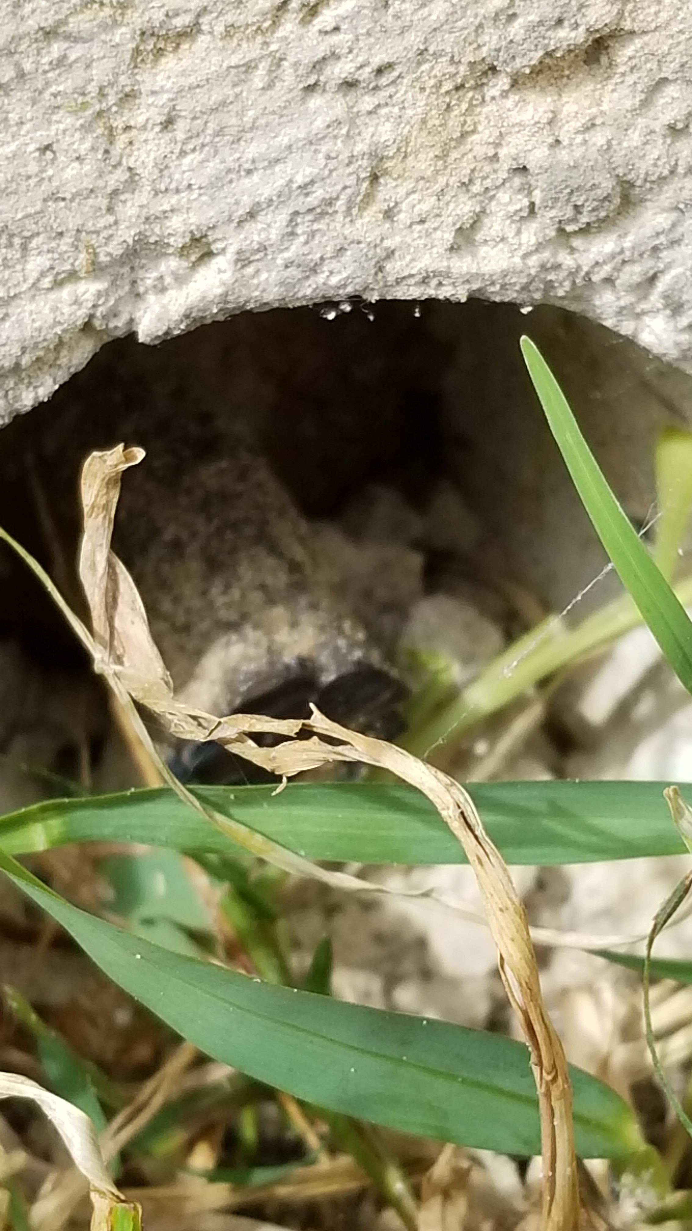

[20200620\_095348|281x500](https://forum.nachi.org/uploads/short-url/8D65sjTBIKrrUrEVzVQEvqD0B5L.jpeg)
 ![20200620_095443](https://global.discourse-cdn.com/internachi/original/3X/2/5/2564ca312e3afe1c060d9acfe332d306c4d0435c.jpeg) ![20200620_094241](https://global.discourse-cdn.com/internachi/original/3X/4/4/445209b579f902ff5be6a8c1140d574bf4caa5de.jpeg)
Hello all, my first time coming!
acroos this. How would i write this up. Need further evaluation, patching required. Due to exposed rebar?

Hey Bennie,
If it were me I’d say something like: “Gaps/voids were observed in the foundation wall on left side exterior (or whatever side). Recommend licensed/qualified professional review for repairs/corrections as needed.”

The photo on the left appears to be a post-tensioned slab tendon with a missing plug cap (which a better photo could confirm), which could be bad. The photo on the right is honeycombing.
The missing plug cap is the item you need to report as a defect, and have an engineer look at.

> [@dtews](#):
**Exactly what it looks like to me from Minnesota!**
