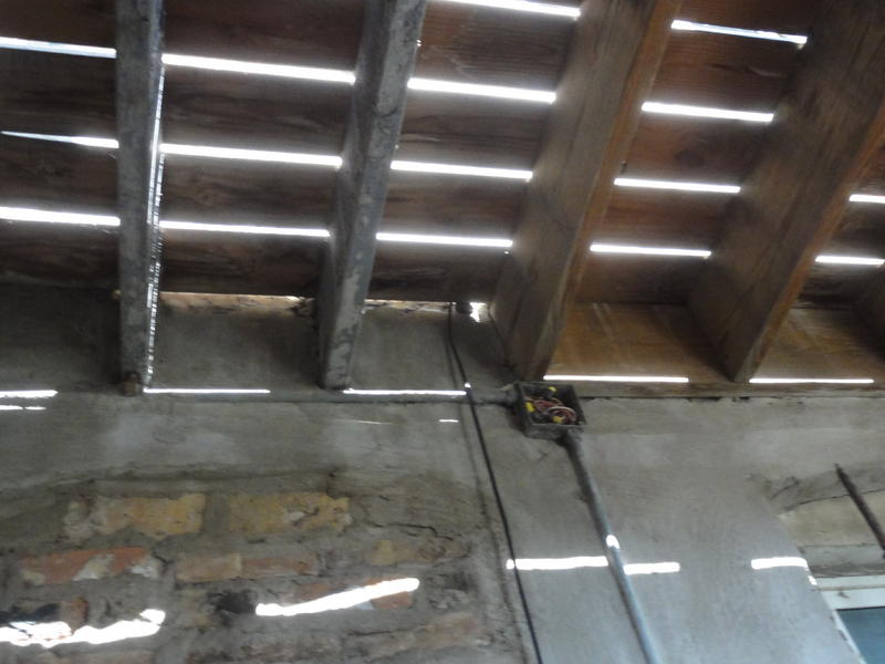

Over last weekend as is quite common around here I discovered more dangerous porches that the city inspectors never found.
Bad post spicing and in particular use of nails to support ledgers at brick are the biggest issues here in Chicago.(yes the one picture features an open junction box.)
[ATTACH][ATTACH]
[/ATTACH][/ATTACH]

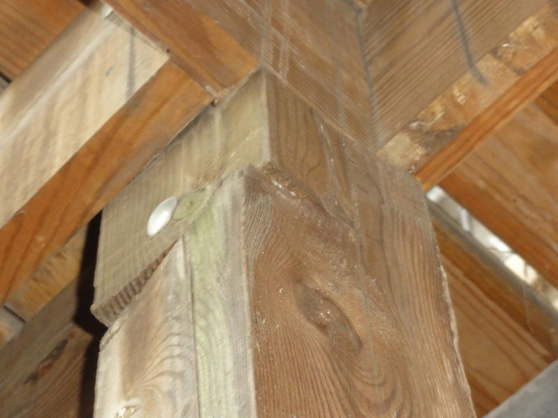

I wonder how soon it will be when we read about these, from recent apartment complex inspection.
Notice the corner post. Also rusted post base at stairways, roofing nails at hangers, face nailing at joist, etc.
Not to mention lack of footers.
