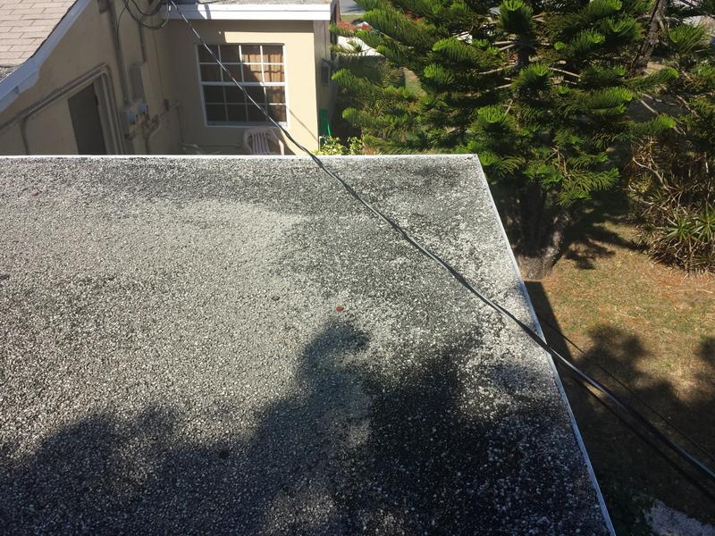

I can’t find the thread, but someone had asked about a low hanging overhead service wire being a safety hazard, and should it go on the four point inspection report.
See the attached picture.
Is this a safety hazard?
Would it go on a four-point inspection?
It is a given it would be written up on a home inspection.
There will also be two other pictures posted after some comments are made.
Absolutely… It is an other electrical hazard.
Some may not not realize it but a 4 point requires the entire system of those 4 points be viewed for defects.
I would note that one, but only because the service is in contact with the roof and gravel stop, not because it is less than 8’ above the roof.

The answer for me would be yes.
The two pictures below are the reason why.
The Realtor called FPL after I showed her these pictures.
Wonder what MM has to say about that.:shock:
Definetly a lot of rub on those wires Eric.
Bert
These are the types of cases where I have seen TECO come out to rectify the situation before we even left the property.
I remember doing an inspection years ago and I when I started the dishwasher, all the lights dimmed. When I turned it off, they got bright again. I turned the dishwasher on again and…all the lights went out!
The frayed insulation was the cause as the two wires arced. I called FPL and they were out in record time…along with the fire department! :shock:
