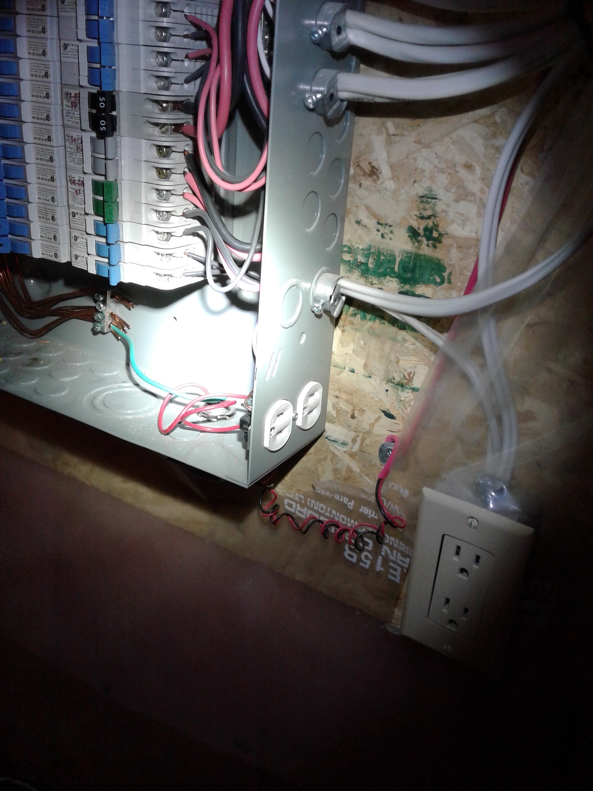

I was at an inspection and discovered this on a 100 amp FPE panel my training is telling me this is a defect but had approval from the local authority i have never seen anything like this before.

New pictures added
Personally, I may put tape wrapped around the receptacle screws before instilling it in the panel board. And a GFCI may be needed for enhanced safety. :smiley: :+1: :upside_down_face:
Otherwise the panel gets inspected just like any other panel. YMMV :upside_down_face:
Looks like a newer Federal Pioneer panel, I assume Canadian.
Is that receptacle cut-out factory installed?
It is a factory receptacle cut -out just never have seen this before.
That being said, the panel is manufactured to accept the recptacle, so it is allowed.

Interestingly, even with the panel mounted receptacle, the Sparky still installed the required service receptacle outside the panel. Kinda tells me they weren’t sure either! :upside_down_face:
