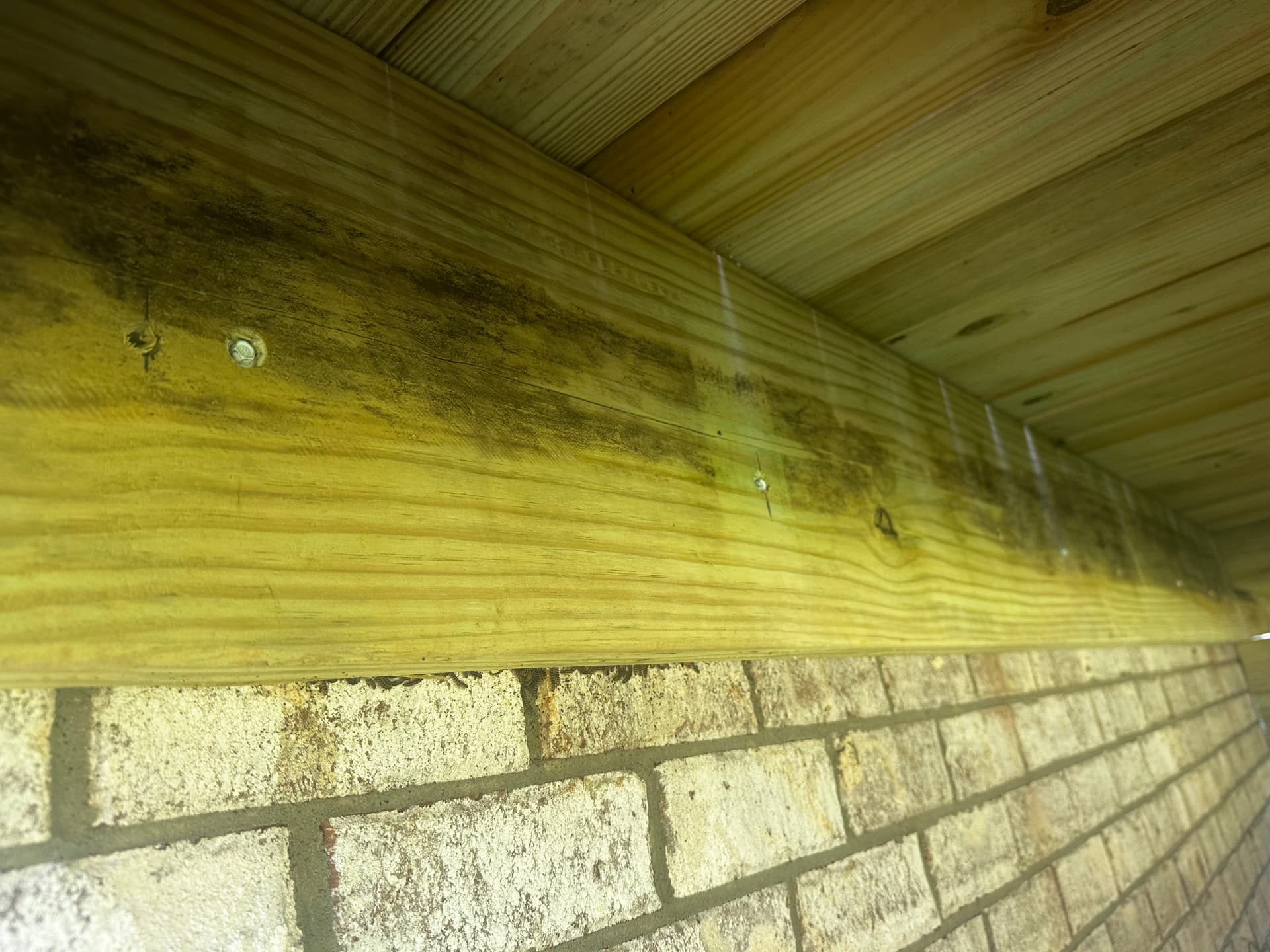

this is the deck I inspected for the essay portion of my how to inspect decks course. I was just curious, this is attached to a brick veneer but since there is a 4x4 within the first 1/4 of the deck expanse this would be considered free standing and not using the brick as a support mechanism right? There are bolts attaching the ledger board to the brick but they seem to be non structural though I’m sure they will carry some weight depending on how the load is distributed. Thanks

Sorry yes I meant to include those! Here is what the ledger board looks like.
It’s possible with the added photos.
Note, they are parallel beams, not perpendicular joists. Load point changes. The load becomes a concentrated load point where the outer joist contacts the side of the home, unlike joists which distribute the load across the ledger. I think it should be freestanding, but the post materials are undersized and poorly placed IMO.

ah that makes sense. Since that ledger board is not holding the joists it justifies it more than I guess. Thanks for pointing that out!

We can tell! lol. They don’t have much experience. No joist hangers, improper load points, parallel joists, etc.

So many things are wrong. But for your question, it is not free standing.
If you pulled the house away from the deck, it would still be standing based on your pictures. Therefore, it is a free standing deck. However, the support method for a free standing deck should be done much better than what your pictures show. It is just a poor attempt at constructing a deck. Looks nice though, lol.
On the other hand…if the deck collapsed it would pull on the brick veneer…therefore “attached.” :thinking:
That’s a collapse waiting to happen. Looks like you have the joists running parallel to the house. The rim joists at the ends are your “beams”. Your “beams” are side screwed into the posts with 4 deck screws. The joists are end screwed into the rim joists with 2-3 screws. Dunno if the deck is going to fail at the joist to rim joist connections first or rim joist(beam) to post connections first, but it will collapse 100%, just a matter of when it gets decently loaded.

Defects are apparent.
Yes they are. They just do not rely on the home for vertical support, but it is often a lateral brace.
