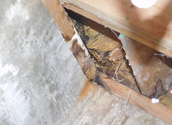

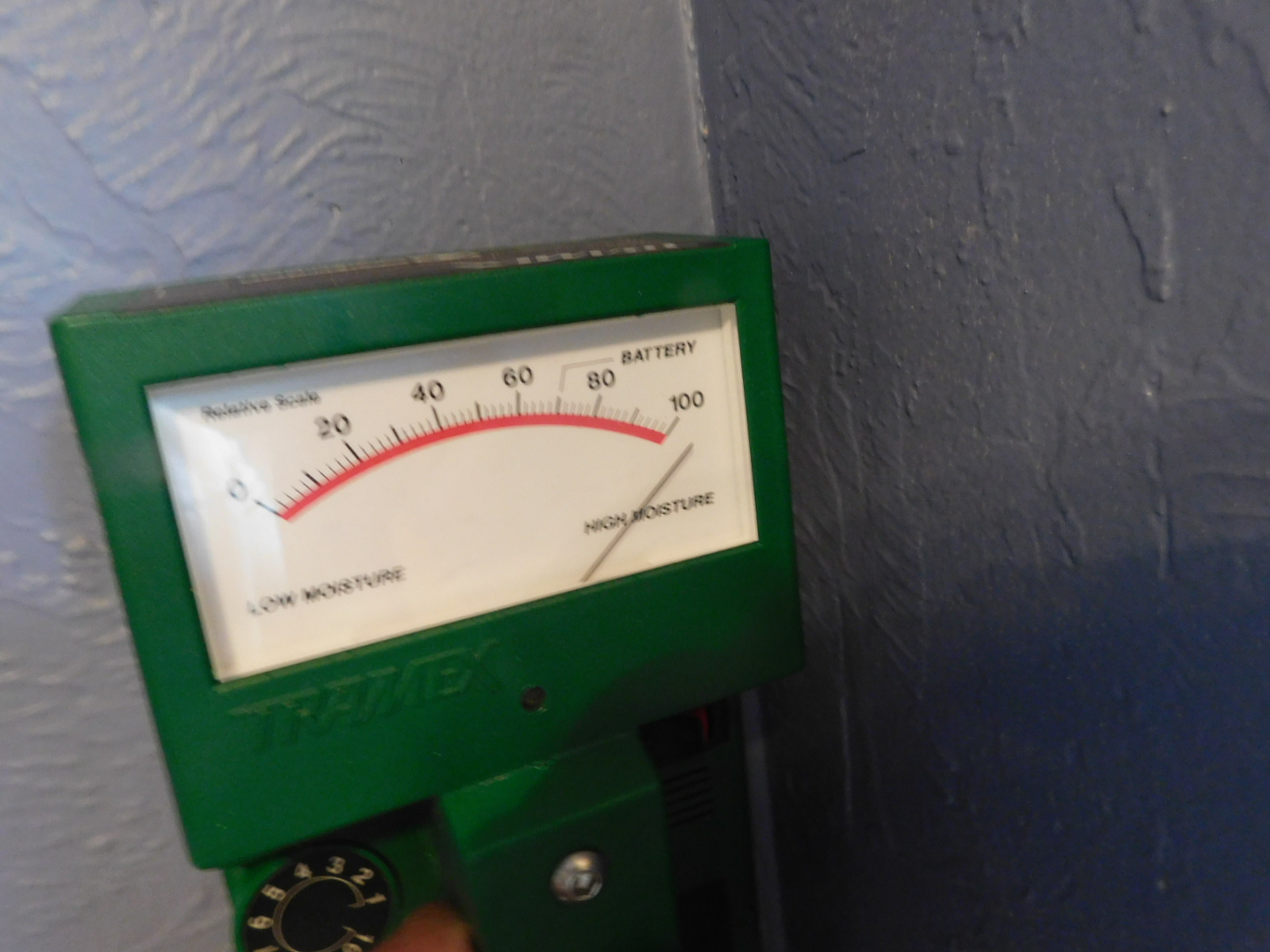

The home has synthetic shake shingles and stucco exterior siding with visible indications of moisture intrusion around windows and on arch flashing. We followed the trail of moisture into a wall with the thermal imaging camera and wet wall moisture detector where the moisture damage was physically visible from the crawl space.
