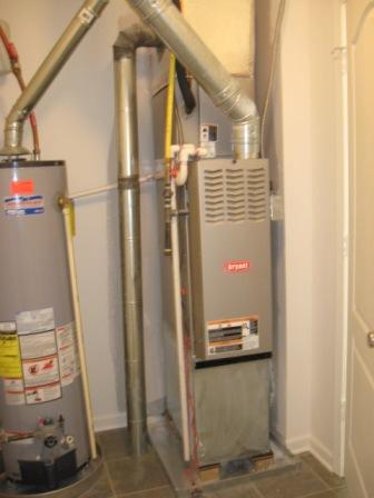

Can someone tell me what the purpose of the flue on the left side of the gas furnace is for? It’s the one going from the floor and into to supply plenum. Could it be for combustion air? This room was 6X12X8 and didn’t have a source of combustion air. Thanks in advance for the answer.
It looks like it is going to the air plenum. It could be a fresh air supply, although I can’t tell if that is the return air or the condition air side (fresh air would be on the return air side). It could also be a duct that was added for heated air, although I would expect it to be insulated.
It does not look like a combustion air duct.
It’s on the conditioned side of the air.
That is an upflow furnace return air on the bottom A-coil on top. Can not tell from the pic but it appears that the 3 inch round duct is just resting on the floor I guess it did not penetrate would that be a correct assumption.
I would not have a clue why someone would dump supply air into that space so close to the hot water heater. Did you run the blower to see how much air was being discharged if any. All that would do is bring air from the other section of the home thru the return and discharge into that room. They perhaps were thinking combustion air but to my way of thinking that is not the way to provide it.

In addition to the strange flue configuration, the condenser/compressor fan would turn on for a fraction of a second while the furnace was operating. Also, the furnace burners would turn off before the thermostat indicated the desired temperature was reached. I think that might be combustion air issue. Also, the house was very cold when I got there, but the thermostat was set to 65 degrees and in heat mode. There wasn’t a return vent on the first floor.

What is directly under that space? I am assuming this is the basement, but you never know with some houses. Could this be an attempt to half a$$ a sub-slab heating system?
The first floor is underneath this room. It’s a two story slab home. The supply plenum goes into the attic and the ducts feed down from the there. It’s rare to see the water heater/furnace located on the second floor in the same room here. I’ve only seen this type of configuration here once before in several years. It was almost exactly like what I saw today. Must be the same rouge builder!
My guess is they forgot to run ducting to an area of the house that was supposed to be heated and cooled and bastard fit in a duct.
LOL…want to find out where it goes and have some fun…drop a golf ball down there and see where it comes out. Just kidding…don’t do that for real!
Sounds like you already explained it (Botched) you never stated where the duct terminated in the room with the furnace or below into the first level. Makes a big difference.

Skip, I am a 12YR HVAC Tech and what I can tell you is “IF” the 3" duct along side the heater is in deed feeding combustable air to the unit, that is aginst code. Carbonmonoxside can enter the conditioned air steam. As far as the unit short cycling… Yes it could be a high limit switch opening on heat rise. 1st check filter condition. Bad air flow across your heatexchanger and cause this problem. 2nd check your fan opration. Make sure the fan in turning and turning in the right rotation. 3rd make sure your A-frame or N-frame coil is clean.( This is the Evaporator coil on the unit). these are a few simple things to look for.
It looks like a supply air duct to a register below to me.
