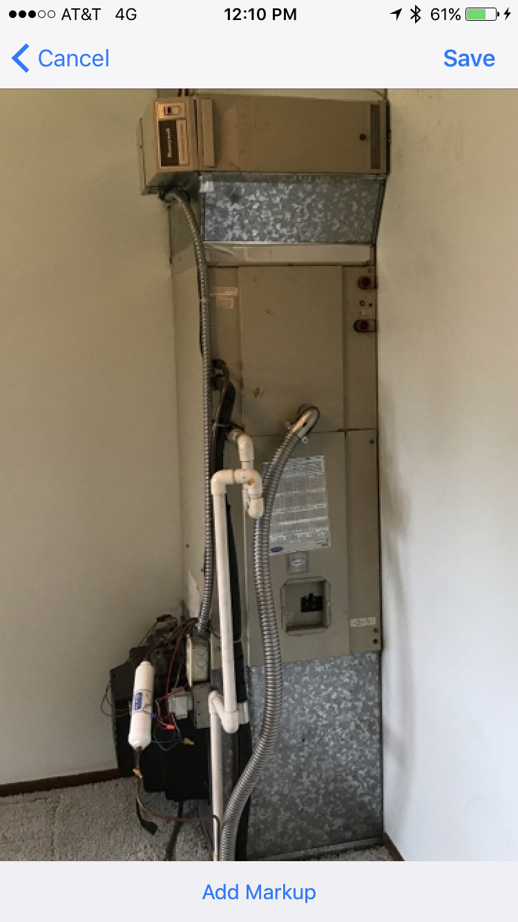

Furnace in bedroom
Found this in a bedroom. Any thoughts? It was a second furnace controlling half the house.
No problem when furnace/air handler is electric. Only fossil fuel furnaces not allowed in bedrooms.
It’s a mid '80’s Carrier, surprised it still functions.
Not much to go wrong with an electric furnace. Just keep em dusted :wink:
True, but the A/C coil is the weak link…
