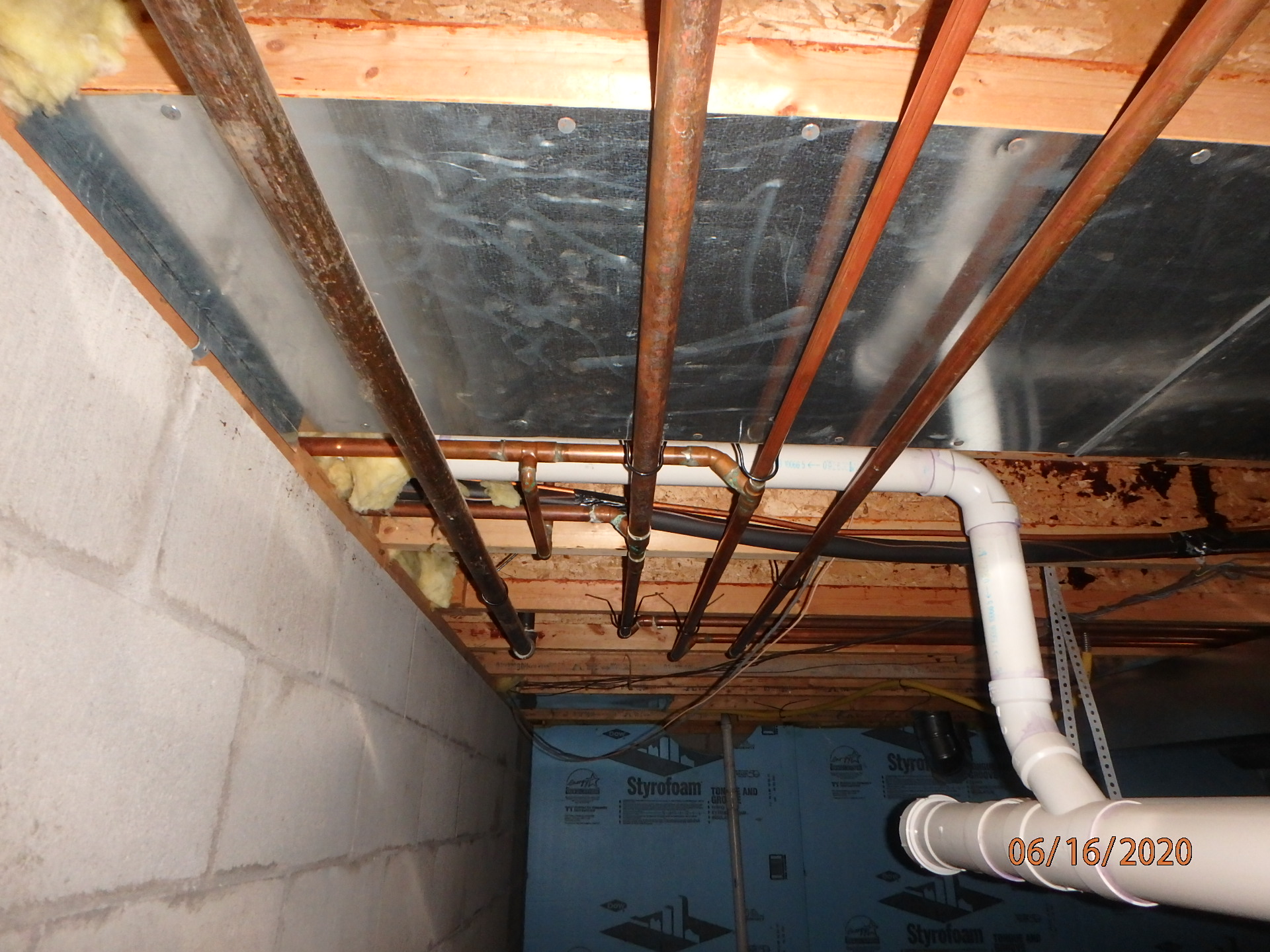

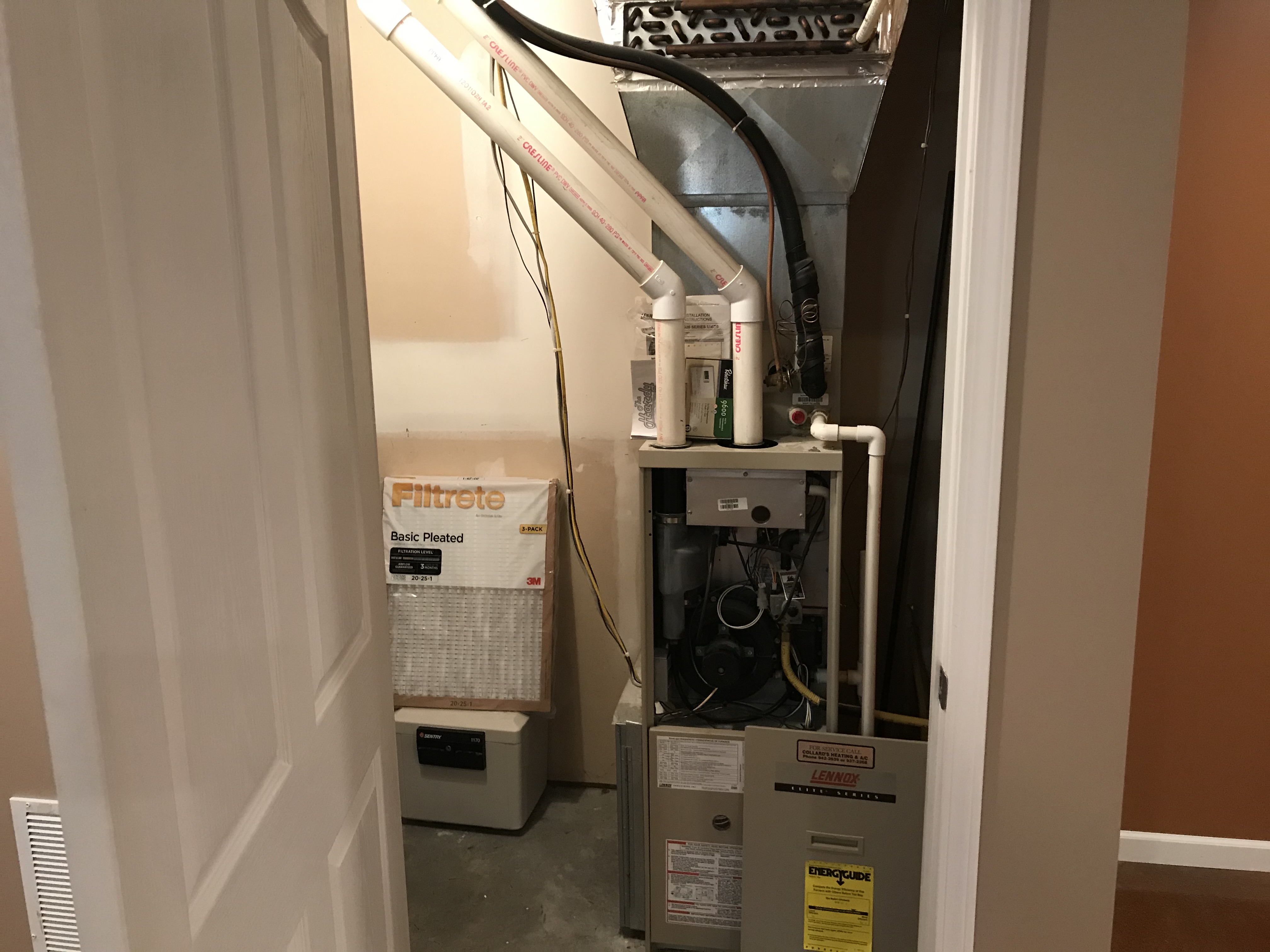

I came across a strange set-up today. The furnace is located in the basement below the stairs. The underside of the stair are exposed so I did write up that they need to have drywall installed. My question is regarding the return air. There was a through the wall grill installed to combine the under stair space with the rest of the basement, and the ceiling is not finished. The main floor is on floor trusses. They appear to be using the underfloor space where the trusses are to return air from the main floor. Return grills are installed at two locations on the floor of the main level without any ductwork. This seams to me to be less than ideal and a fire hazard as the furnace will be pulling air through the trusses if it is operating during a fire. 1. Are these assumptions correct? 2. How do I explain that to the client without scaring the heck out of them?
 ![IMG_5407](https://global.discourse-cdn.com/internachi/original/3X/7/d/7d74f9f2865403bf368dba096b7fe412cc7323a2.jpeg) ![IMG_5406](https://global.discourse-cdn.com/internachi/original/3X/2/5/25171641214c05e1a7f163340ffd795127e93baf.jpeg) ![IMG_5405](https://global.discourse-cdn.com/internachi/original/3X/9/0/903178f119be7fd0fb876ddfa15b0e672e14d629.jpeg) ![IMG_5402](https://global.discourse-cdn.com/internachi/original/3X/7/9/7949adfc98c0e9c0e410ba5c226617d754ae0b3a.jpeg)

David,
This sounds like simply an amateur install, without ductwork. The home will never be comfortable.
You can jam a furnace in wherever you want but a balanced duct system makes all the difference.
As far as a fire hazard, no. Unless there’s a clearance issue we can’t see from here.

Once upon a time it was comon practice to use foil coated cardboard stapled to floor joists for return air. Cheap alternative to ductwork. The open space between the joists was the return duct.
 ![IMG_20201006_201951978](https://global.discourse-cdn.com/internachi/original/3X/6/e/6eef5f224e722533fcd3549861baa231a8d06b5f.jpeg)

Panning the joists from the return air grilles back to the return air trunk line is how its done today, in most areas.

It becomes a fire issue with the equipment itself being under the exposed stairs.

Not in my area, panning joists and using it as return air is cheap installation in cheap builds.

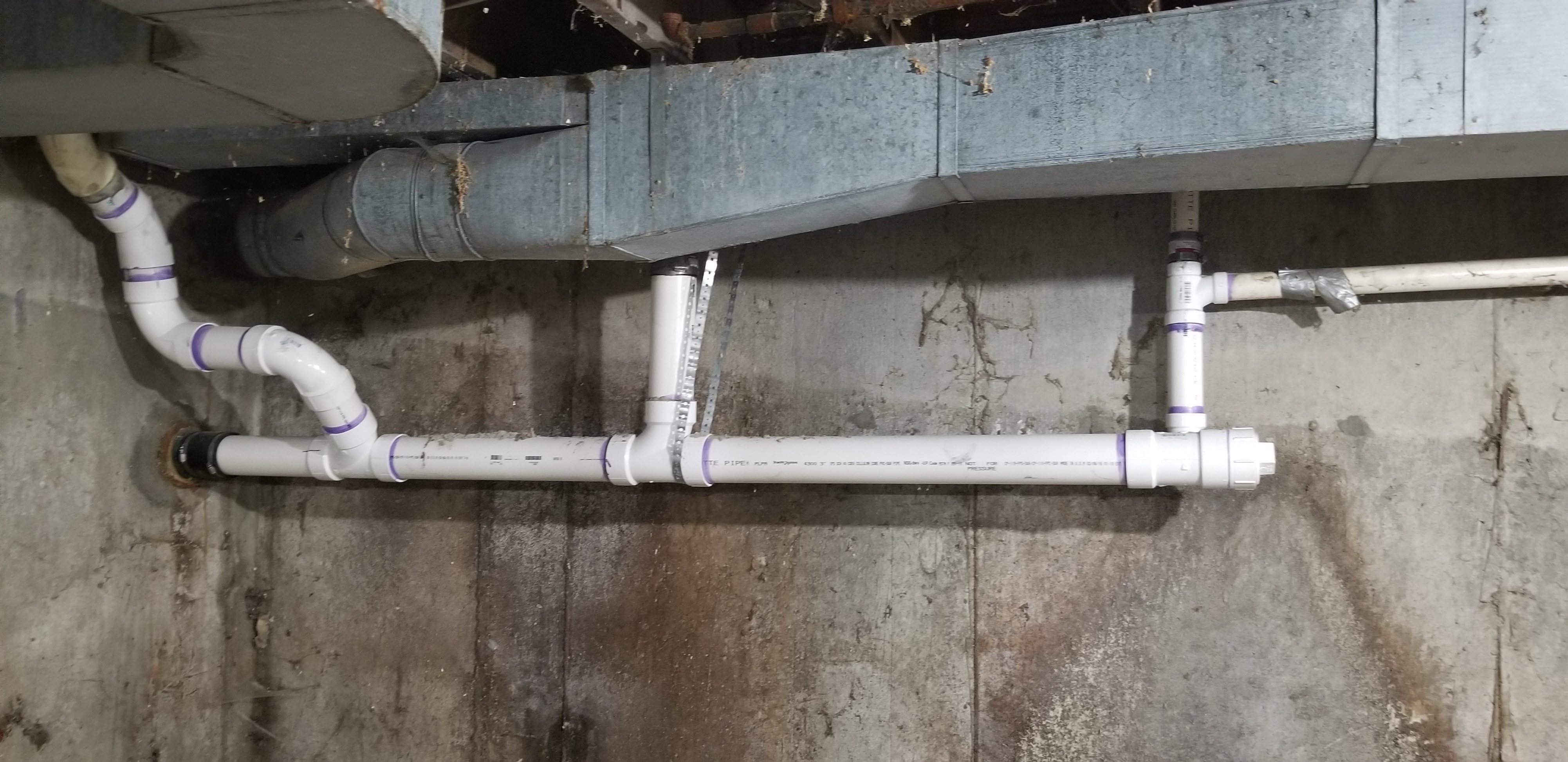

How about a picture on how return air ducting is installed in your area?

I can’t see any return air ducting at all. The floor trusses run perpendicular to how the return duct would need to be installed. I think the whole under-floor area is acting as a return will just a couple of holes cut in the floor.

The return air isn’t properly installed or at all.
Have a heating contractor repair.
The furnace has been running but not able to properly heat/cool the home. Again, lousy install.

Using metal or flexible duct work:
 ![20200229_121237](https://global.discourse-cdn.com/internachi/original/3X/2/e/2ebd16d8c270edf496d3e7b80ca008a5e9bb3753.jpeg)
 ![20200229_121238](https://global.discourse-cdn.com/internachi/original/3X/1/c/1c50ccc5abd5de7bd3a52a63416e1289bf121be0.jpeg)
 ![20201007_130703](https://global.discourse-cdn.com/internachi/original/3X/d/0/d084101e6da8600a6796a2ee56b1e6417999caff.jpeg)

No difference in quality of system. In fact, if the installer isn’t careful with flex duct and there’s too long a run, too many bends, etc., the resistance and pressure drop is too high.
