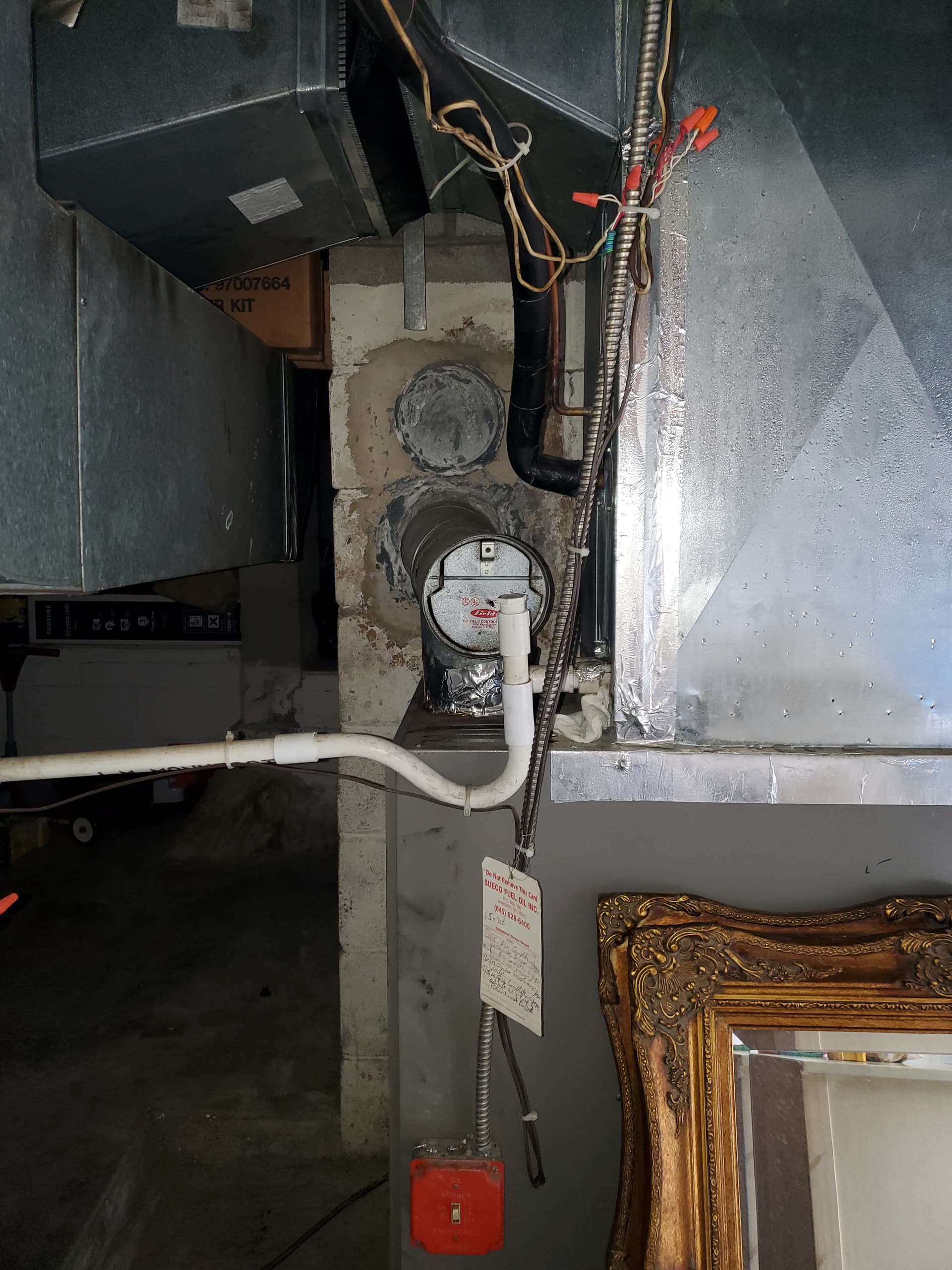

I came upon a furnace in a friend’s home and noticed a tissue being used as a plug because of possible backdrafting issue. I brought it to his attention and told him he may want to call a H Vac technician or a plumber. I am still in the learnig stage and H VAC and furnaces always has me boggled. My question is did I point him in the right direction?
I see a tissue but it doesn’t appear to be affecting the draft.
A Barometric damper regulates the draft on oil-fired heating equipment pretty well in my experience.
I don’t think so. That tissue may have something to do with a condensate leak but not draft.

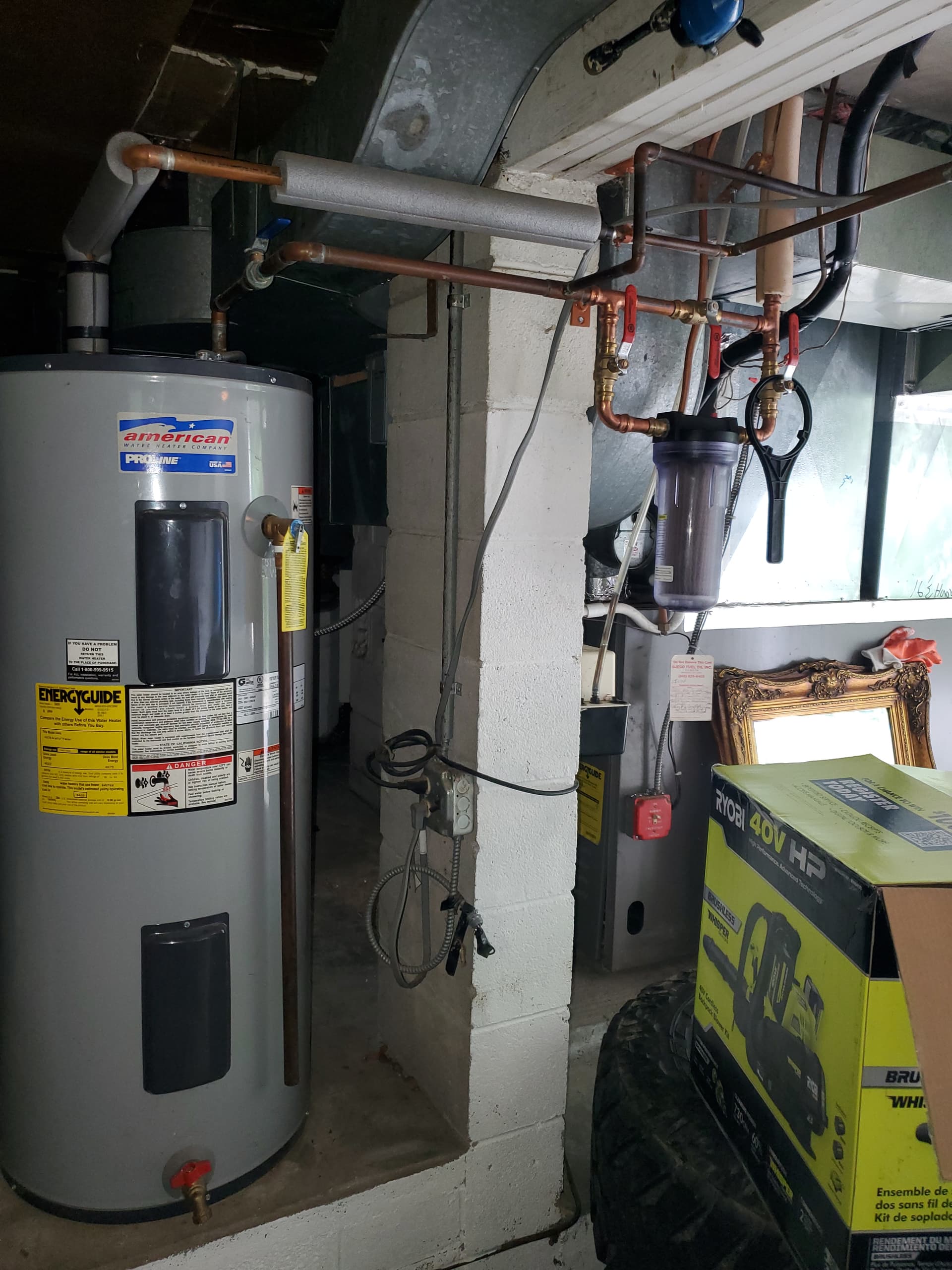

My only concern here is the Ryobi tool. Point him in the direction of the yellow or red tool Isle.
Lol that was funny. Lol. Well thank you. AAgain I am in training and you guys help so much.
