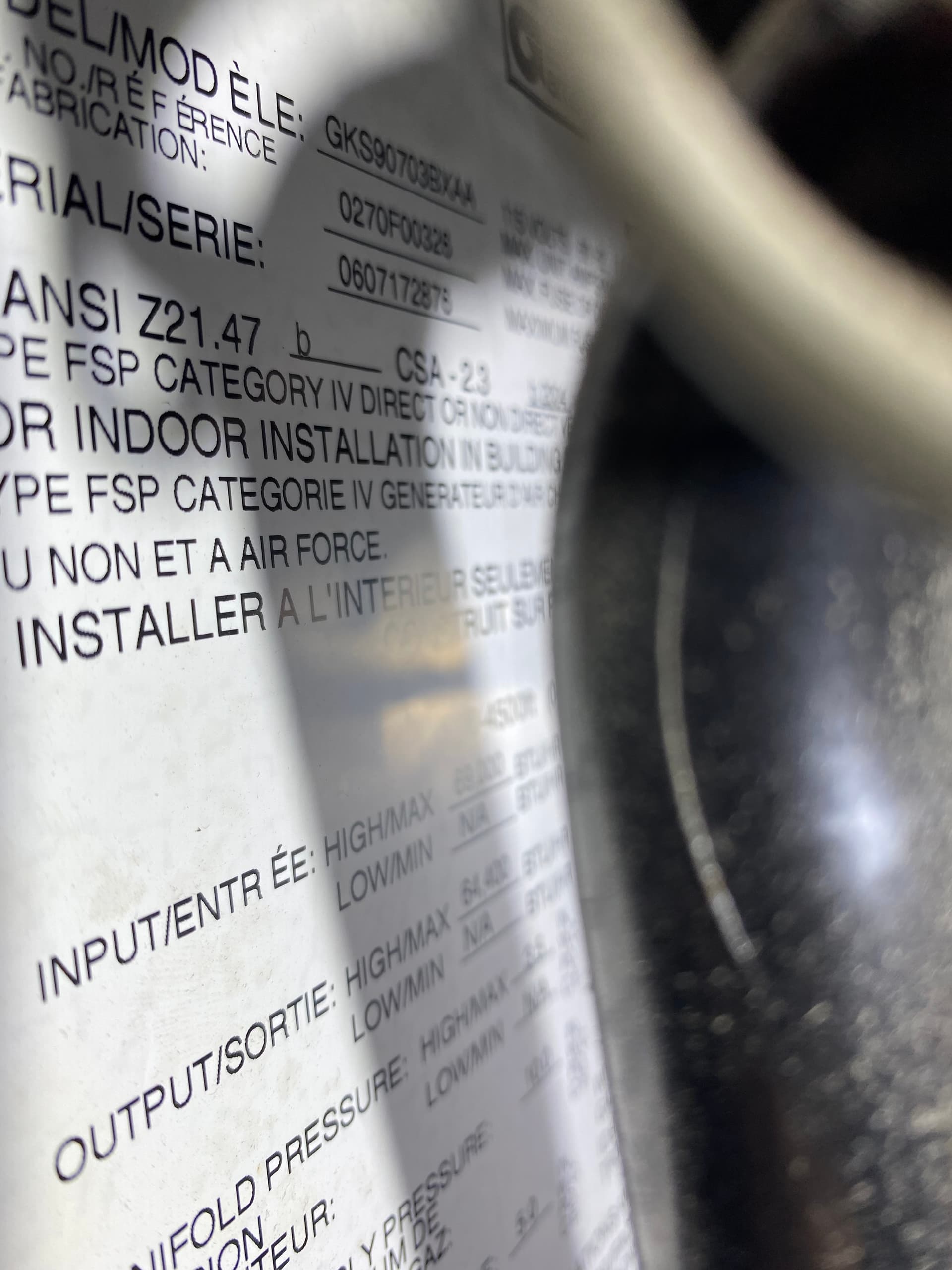

What’s the exact model number? Photo of the nameplate?

**Author:** ![melyussif](https://sea2.discourse-cdn.com/internachi/user_avatar/forum.nachi.org/melyussif/32/182290_2.png) [@melyussif](https://forum.nachi.org/u/melyussif)\
**Post date:** [September 19, 2021, 3:27am UTC](https://forum.nachi.org/t/furnace-pipe-whats-it-purpose/203805/7 "2021-09-19T03:27:38Z")
</div>
![IMG_8573](https://global.discourse-cdn.com/internachi/original/3X/f/8/f8d81019fac19c8d433bc94d465e65a8f7bb9e20.jpeg)

Thanks, Mike.
Goodman GKS90 - 90,000 BTU - Gas-Fired Furnace - NG - 92.1% AFUE - Single-Stage - Upflow - Multi-Speed.
Vintage equipment. Product discontinued. Replacement recommendation: GMSS921004CN. Age:
Age: Approximately 15 years old.
Probability of failure. Medium.
Recommend a licensed HVAC contractor: 1: service the furnace prior the next heating cycle.
Looks like a scorch mark on the under side of the exhaust flue.
