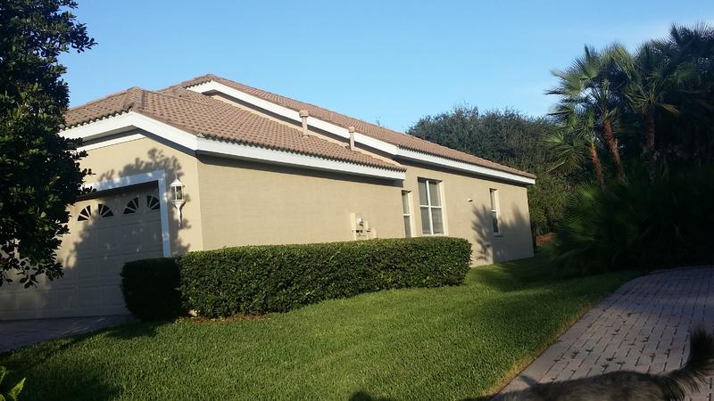

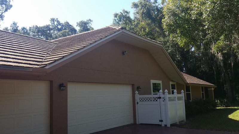

Gable/hip
Is there any gable in this picture for a wind mit?
the 2 side pieces that are not hip
Gable
Isn’t it called a half gable, or partial gable or some such thing. Either way, not full hip.
clipped gable
And that is ALL that matters :frowning:
Measure the entire horizontal distance across the clipped gable and subtract the middle horizontal segment ----- what your left with is the non hip distance to be applied to the overall 10% rule,
The best answer!
Okay, so if it is horizontal it is hip and if it has slope it is gable.
if it slopes to the wall then it is a hip, all else is non-hip.
Okay, thanks.

This gable running across the center counts as part of the roof line, correct?
Not as the perimeter, but other roof.
