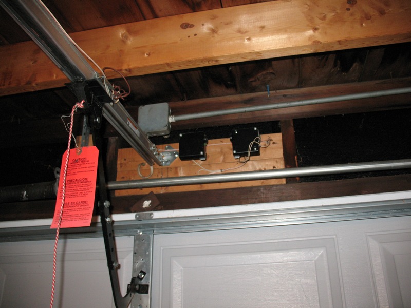

Garage door sensors above the garage door?
According to the InterNACHI Res. SOP:
2.10. Doors, Windows & Interior
I. The inspector shall:
E. and report as in need of repair any installed electronic sensors
that are not operable or not installed at proper heights above
the garage door;
Are sensors supposed to be installed above the garage door?
3 to 6 inches above the garage floor.
Above the garage door??? that pic looks like a double garage and the pic does not support your explanation
This would be above the door.
Yes…I guess that would be
LOL Bobby----:lol:----](*,)
And that’s what you are to report - that the door openers in that picture are properly installed above the garage doors. ?? SOP is confusing there - agreed?
the garage door;
No.
Agreed?
Does anyone use the aforementioned SOP Ben??:smiley:
What good are they above the door???
