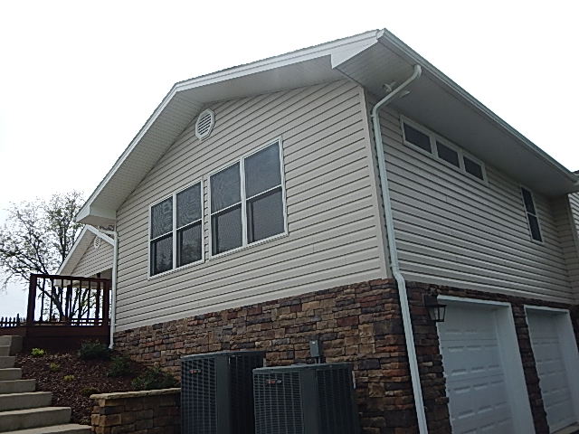

Owner built a new garage with bedroom above in 2010, when was the ceiling separation rule from garage introduced ? I thing there should be sheetrock covering this ceiling, correct. ? Thanks

Yes…
If you look at it as a potential safety hazard, you don’t need to state dates of, or comment on, when certain codes came into effect.
> **[Attached Garage Fire Containment](https://www.nachi.org/attached-garage-fire-hazards.htm)**

The ductwork is also an issue and more difficult to correct. Sheetrock in this case needs to be 5/8 in Type-X. The requirement existed prior to 2010, but that is not important.
