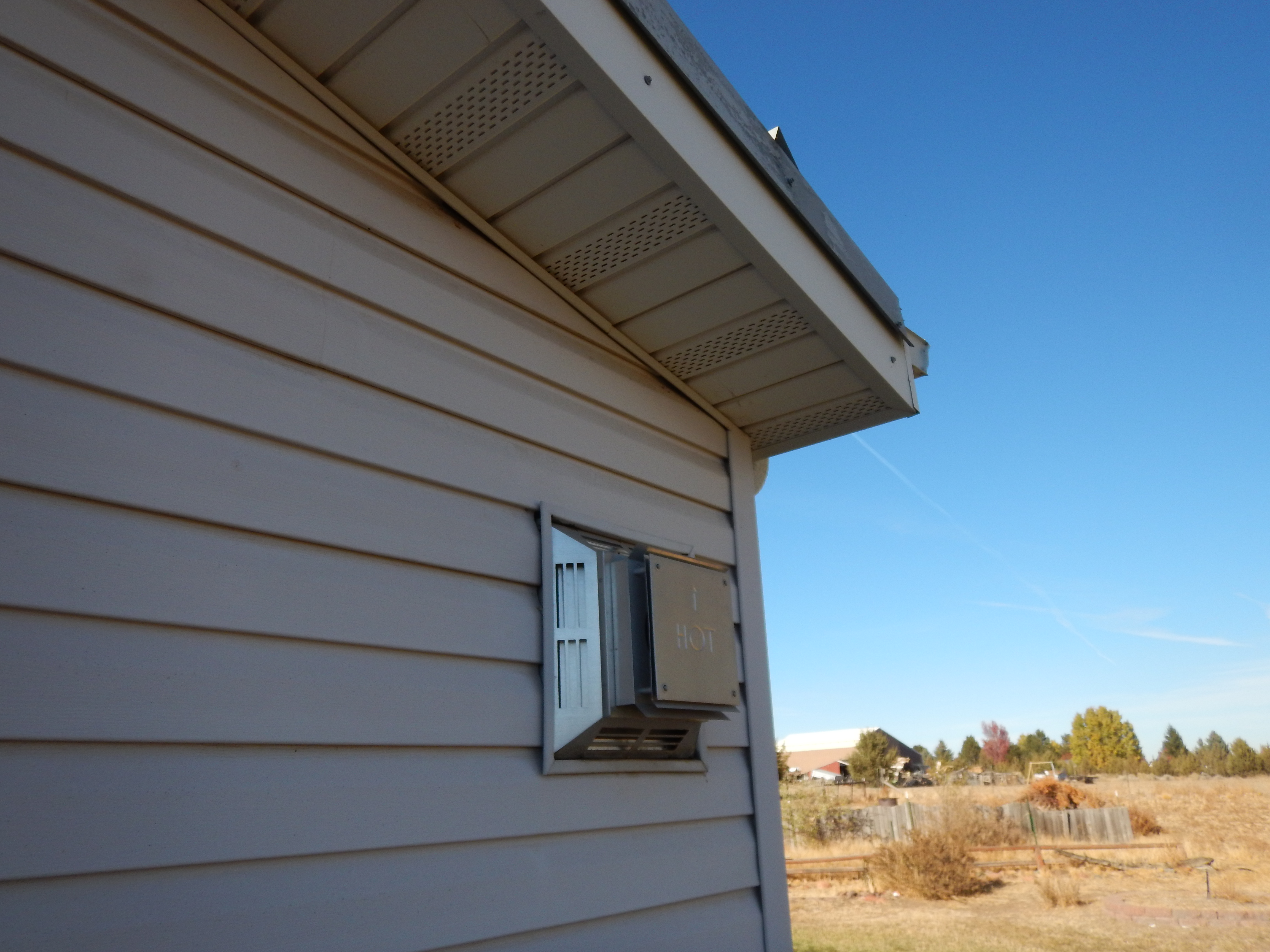

Gas vent clearance to vinyl siding in soffit
Is there any kind of additional clearance requirements of a gas vent to vinyl siding or vinyl soffit?
Look up the manufactures specs (make/model) for the listed appliance that the vent serves; all the clearances will be spelled out.
It will probably be 12" but it could be 24" ,or so, depending on the btu of the unit.
Do what Dominic suggested.
