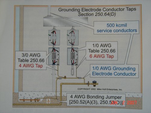

Anyway this issue is cleared up in the newer revision but what Greg is saying is correct…however, this is how it has been done for many years and it seems that many AHJ’s still allow the practice…thinking more in terms of bonding the enclosures together as opposed to it being an actual GEC…and then many say the TAP conditions onder the GEC requirements are then not in play…
I think in the original question it was asked about the GEC and the allowance of the applications for the GEC to each disconnection means is growing with the 2008 revision…but here is a picture of a common way to do a tap on the GEC…
Electricians have been argueing over this very thing for many cycles…it was just easier to call bill…than to do a long and drug out thing here…sorry as it was my choice and I made it…
![Dsc01722.jpg](https://global.discourse-cdn.com/internachi/original/3X/e/6/e609db6e38356e71232a78e9c431b505e2f5e803.jpeg)

I would not worry as much about that Parallel issue…while the application is wrong you are going to have parallels in the water piping system as well if bonded properly and so on…anyway being in place in my opinion is better than not being there at all…or with the lack of a proper TAP method…
Check out the debate on it over at the HOLT site…you will see what I mean…
[http://forums.mikeholt.com/archive/index.php/t-56612.html](http://forums.mikeholt.com/archive/index.php/t-56612.html)
Kinda a Lessor of TWO evils approach really…but in the end…just plain sloppy…
