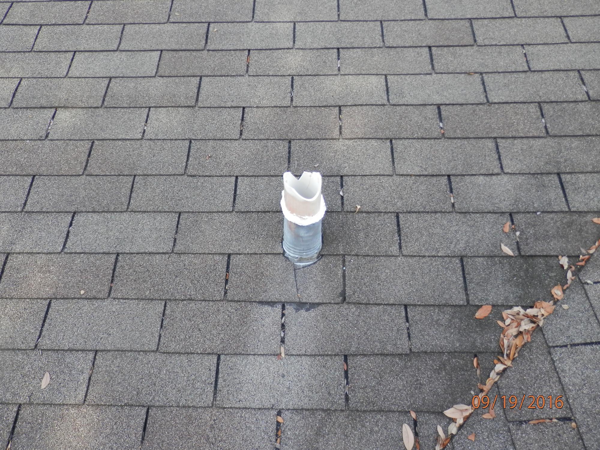

Attached is a photo of a damaged area vent stack with a band-aided lead flashing. The integrity of a water intrusion resistant roof system is in large part dependent on the soundness of all the flashings incorporated in the roof system. Areas of roof penetrations, intersections where roof planes meet, roof to wall and any place in a roof system where distinct direction changes occur are especially venerable to water intrusion and rely heavily on the integrity and proper installation of flashing.

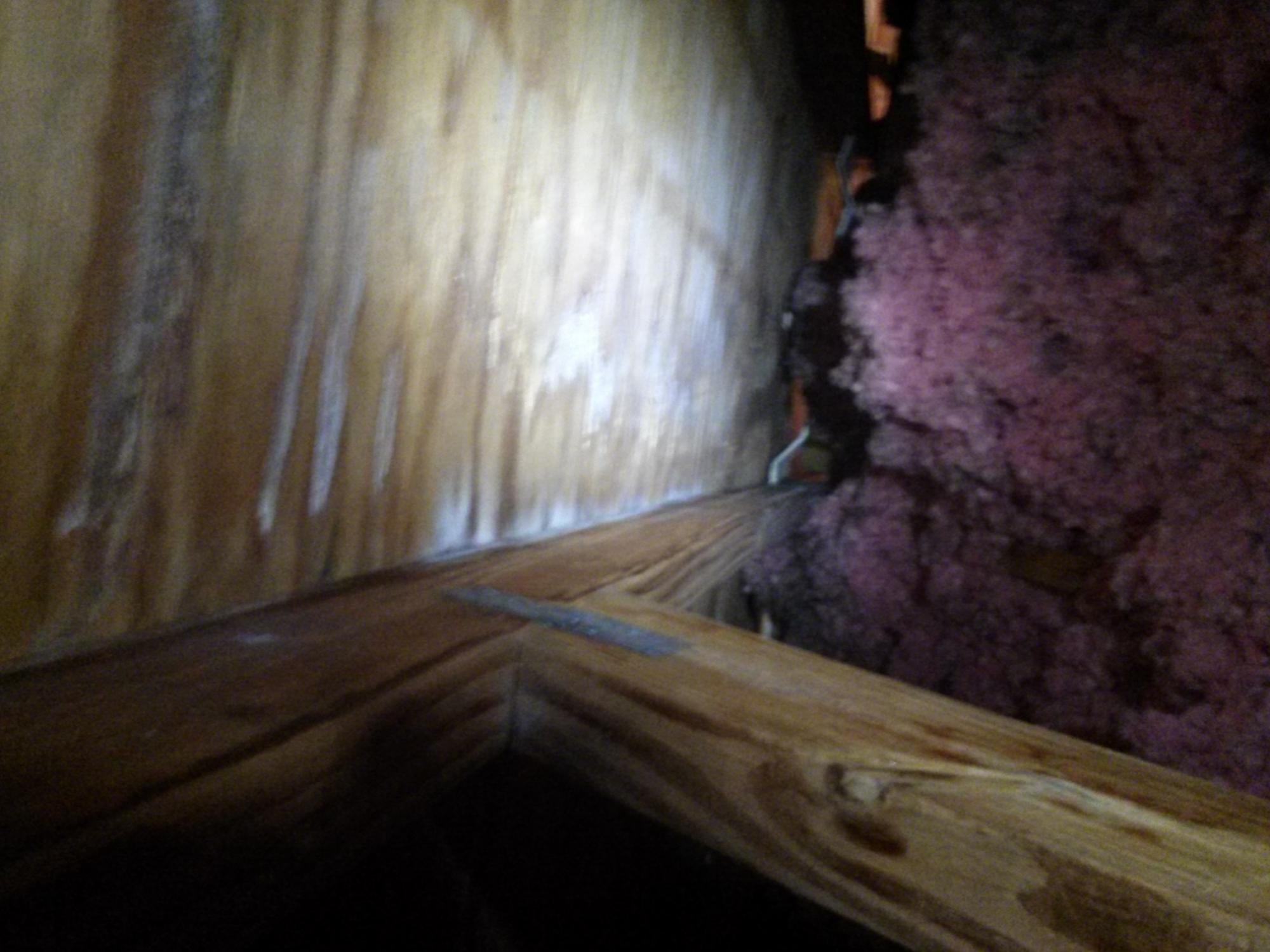

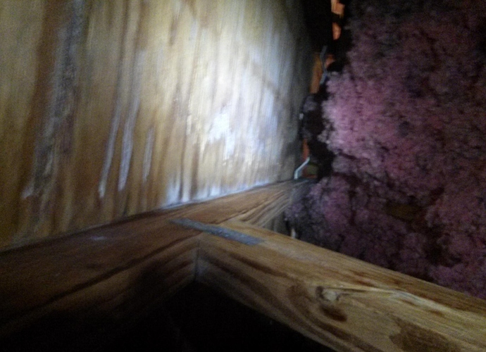

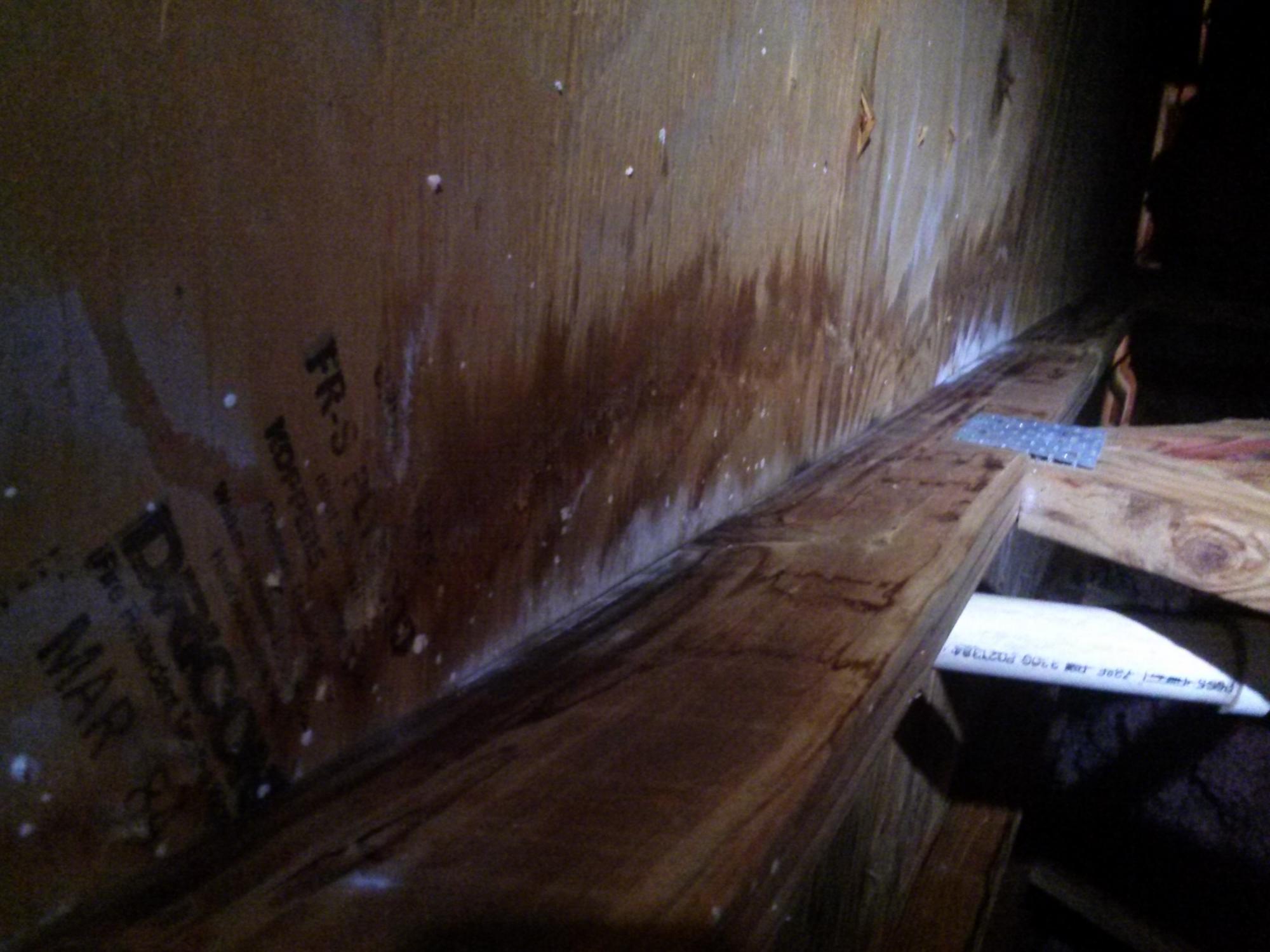

While performing a visual walking inspection inside the attic space, signs of recent water leakage were present on plywood, Also “wet insulation” resulting from a possible roof leak found around the plumbing exhaust pipe. A moisture meter was used and readings were around 31% or “wet” indicating leak still exists.
Plumbing vent pipe need to be properly sealed around the perimeter of pipe boot flange where it has failed.

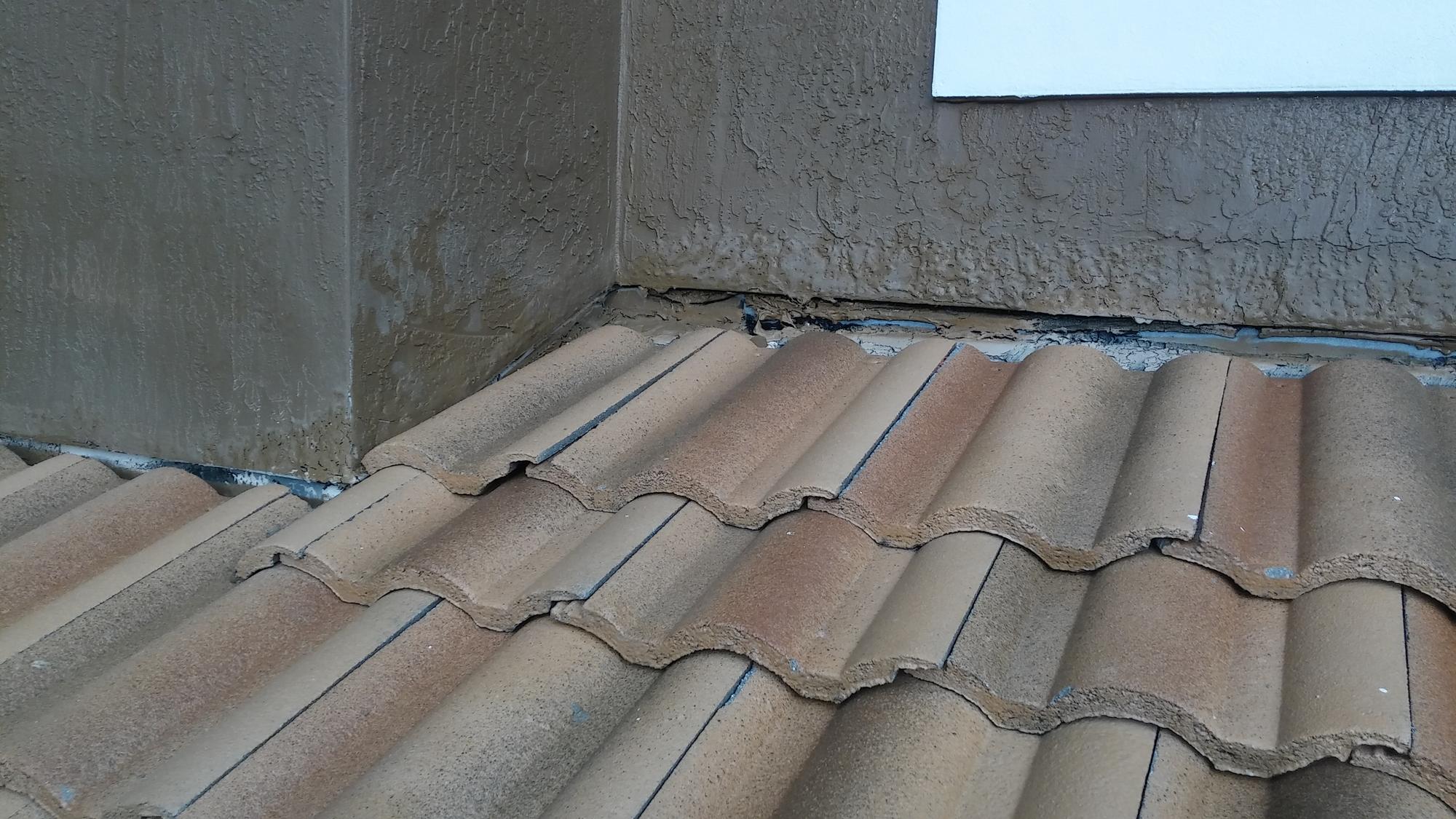

The inspected home was built with CBS along the first floor, and wood frame along the second floor. The exterior walls were covered with stucco, a very typical construction of homes built in South Florida.

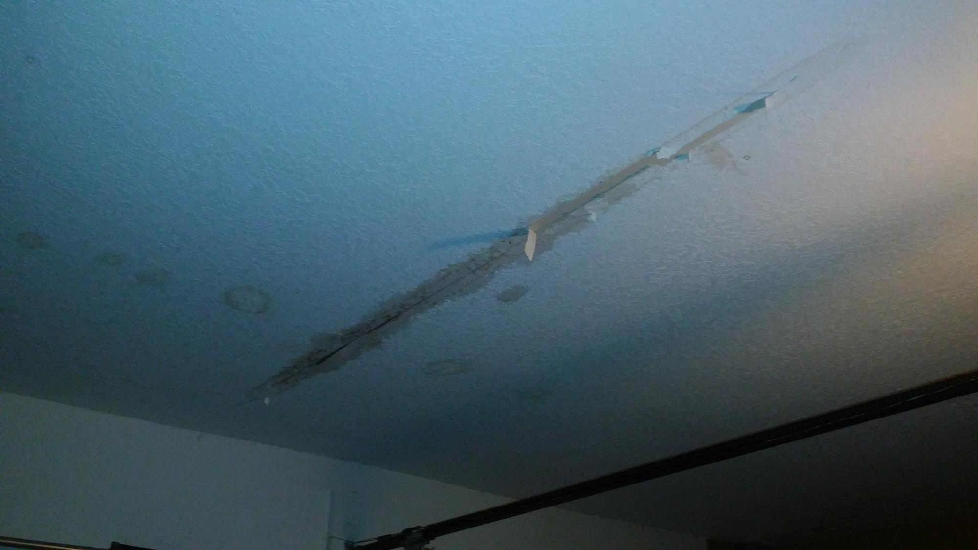

There was a roof leak noted, coming from a small area above the garage. Upon further investigation, it appeared that the headwall flashing may not have been installed properly. Over time, moisture from heavy rains has penetrated the area behind the flashing causing moisture damage to the exterior stucco and the garage ceiling below. There is a small area that is inaccesible that may reveal more damage or decay when opened up from inside the garage.
The recommendation was to contact a roofer for a cost to cure. The home buyer claimed that the damage was minimal. The inspector had to inform the buyer that some decay may be present when repairs are underway, thus increasing repair costs.

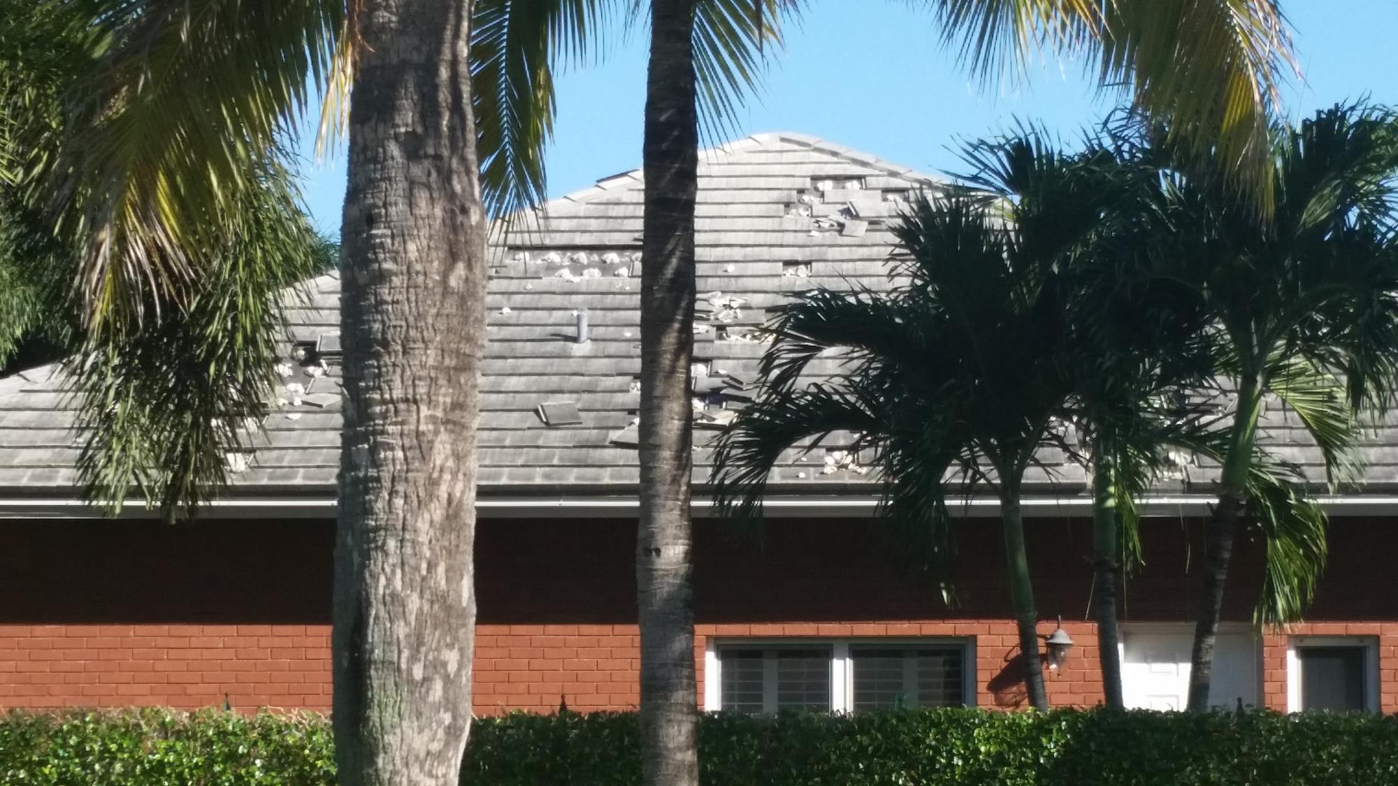

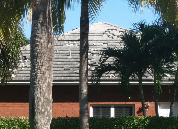

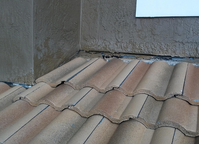

Good mornig all,
attached is a photo of a roof that has a bad case of deferred maintenance.
There are multiple either mising or broken tiles. This is a bad situation for the house and the neighbors. The felt underlayment may help keep some water out of the atick but in south florida, roofs are subject to severe down pours daily. Not to mention this home is located in a hvhz which means exposure to high winds and rainfall amounts in the double digits. As for the neighbors, all of those pieces of loose tile, are potential missiles. Category 3 and possibly category 2 hurricane force wind would probably shred the rest of this face of the roof as the exposed areas of the deck will allow wind to penetrate and increase pressure under the cladding.

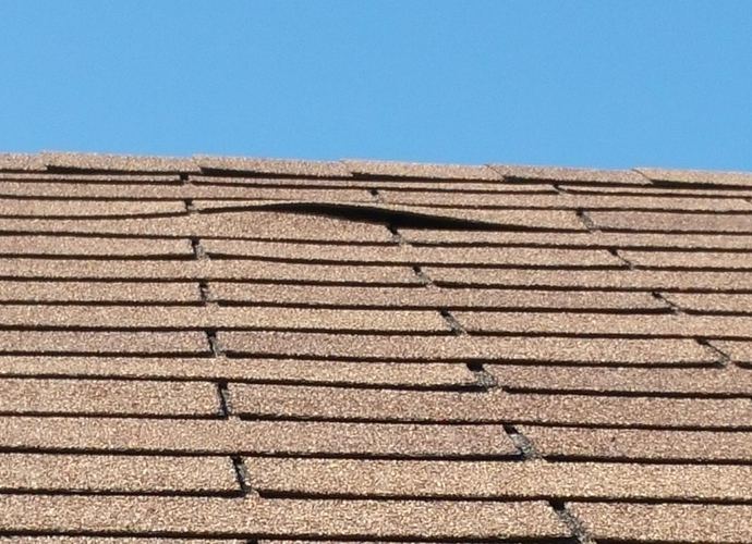

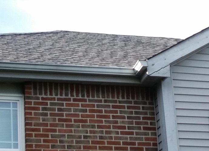

Roof Inspection: Bulge noted in shingles on attached garage near ridge that will cause premature ware of shingles. Cause cannot be determined without a destructive inspection. Advise repair be made by qualified roofing contractor.

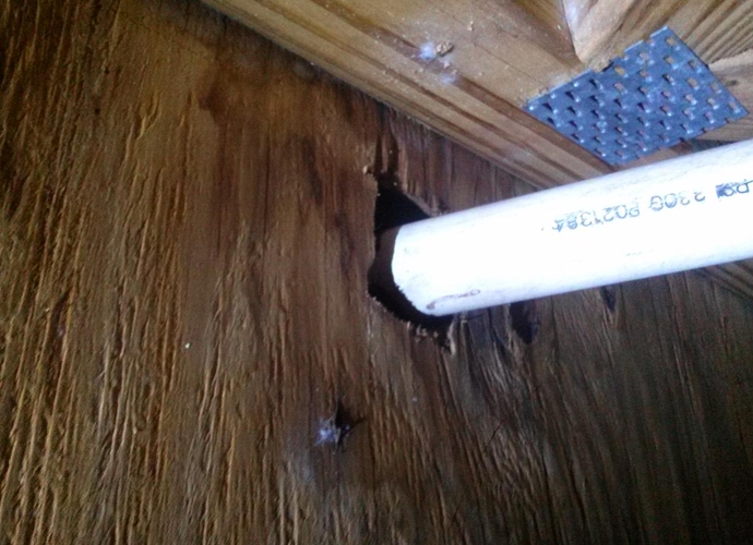

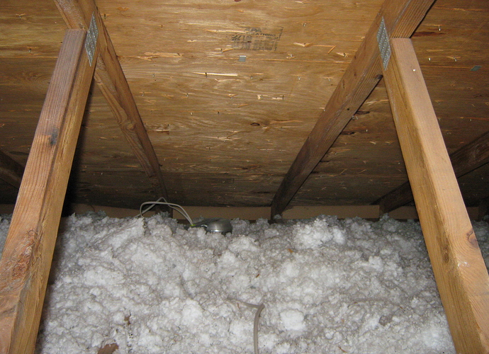

For the 4 point roof inspection upload, I took a picture of my roof decking and the outside edge of the roof. The roof decking is 7/16" osb board installed with 6d nails and held together with hclips. Upon inspection, I could see no water or black stains on the decking and was unable to detect any moisture with my meter. The edge of the roof picture was taken to ensure insulation was not clogging the soffit ventilation. Card board strips had been installed to ensure insulation was not blocking venitilation.

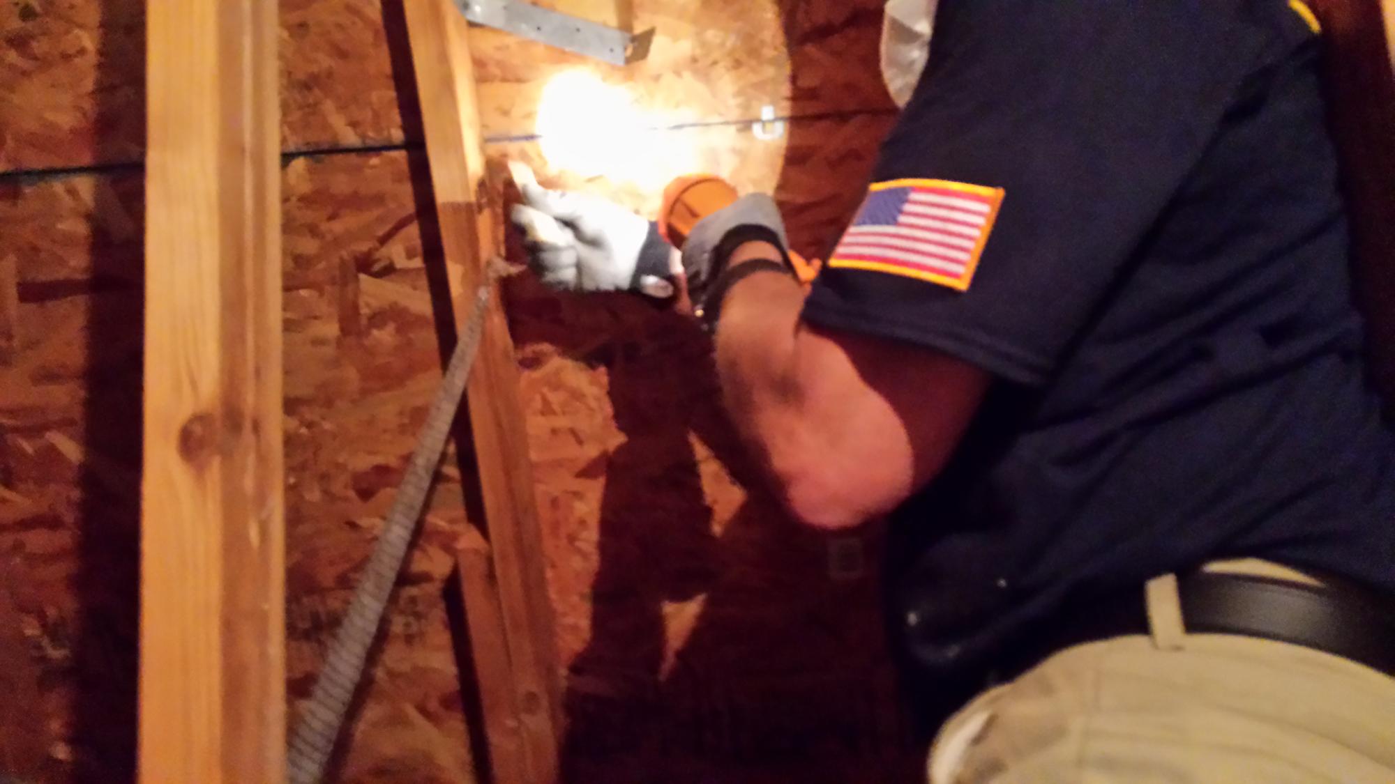

The two articles chosen for the General Roof 4 point were Collar Ties vs. Rafter Ties and H-Clips. Collar and rafter ties are both horizontal roof framing members under tension. A collar tie or collar beam is a minimum 1x4 board spaced 4 feet on center located in the upper third of the opposing gable rafters and is intended to resist separation from the ridge beam beam during times of an unbalanced load. ( snow / wind) A rafter tie is located in the lower third of opposing gable rafters that is intended to resist outward thrust of rafter underload. H-clips are small steel devices that fit snugly between wood panels in order to provide them with edge support. Their use is dependent upon local jurisdiction.

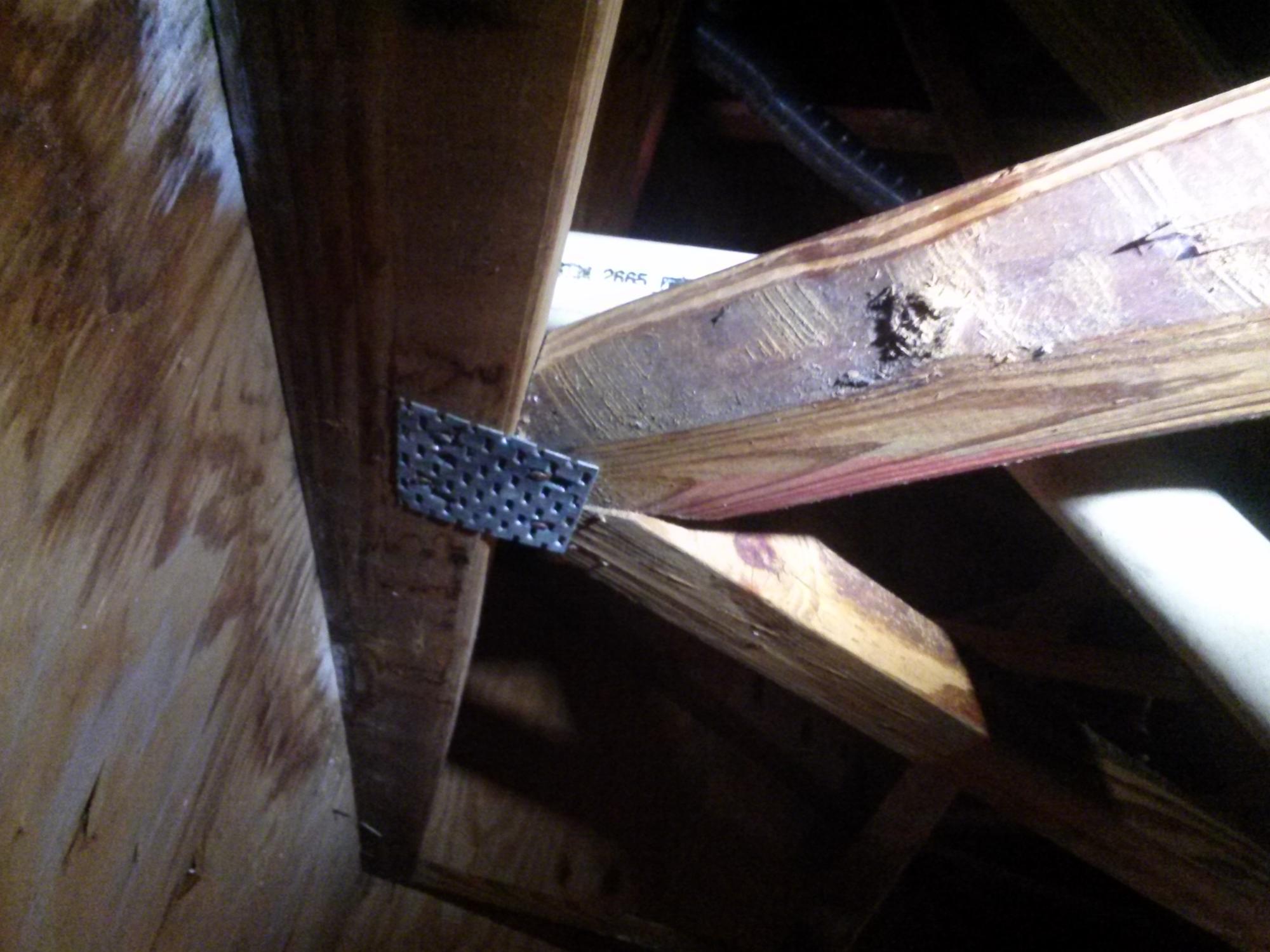

Up in the attic verifying the sheathing type 1/2 " OSB, type of fastners 8d, found the presence of H clips, and verify the length of roof nails as 1 1/4 inch.
Also verify the nail spacing for roof sheathing material with in 6 inches of each other.
No evidence of leakage.

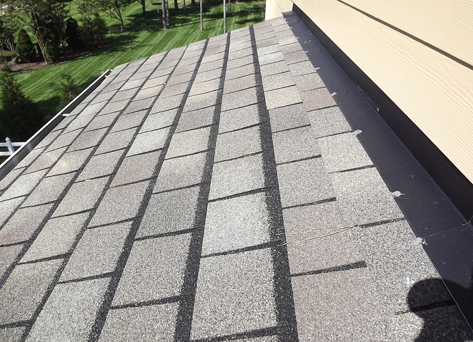

I took a photo of a kickout. The kickout shows the attention to detail the roofer put into this roof. It may look rather insignificant due to its size but it really does help divert water away from the house when it rains
