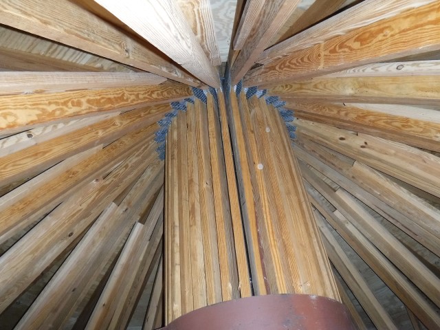

Yes the roof ventilation was my first thought. It seems they just completely filled the whole triangular shaped section with insulation. No ventilation.

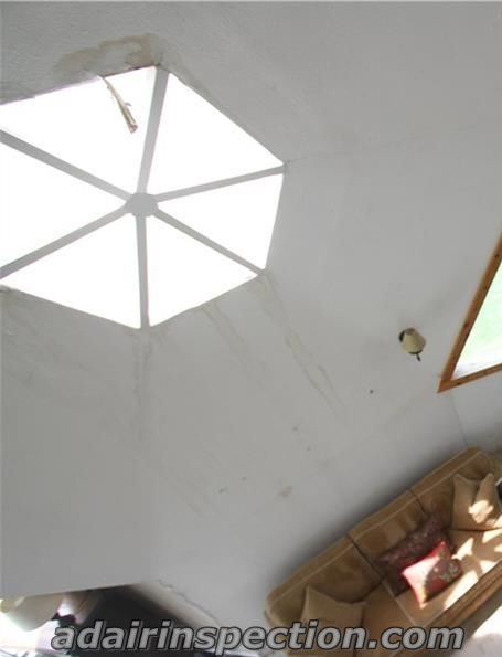

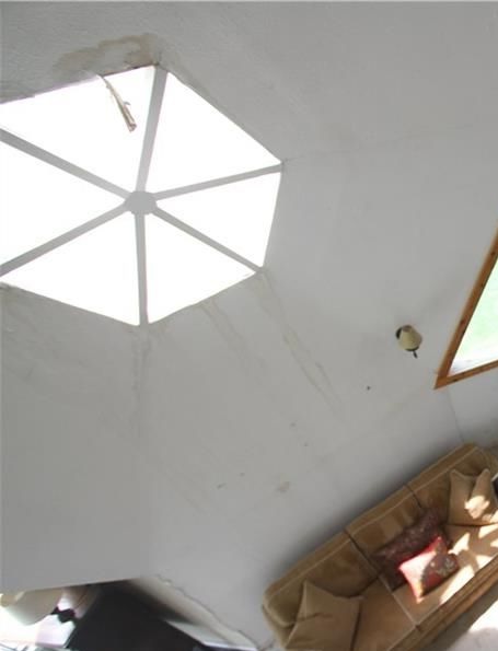

Moisture intrusion was evident. It had these triangular shaped skylights that appeared well flashed but some of them had failed seals and the interior well area had moisture damage that seemed to migrate downward along the triangular frame behind the drywall. The biggest issue with this house was the deck that surrounded it at the second story level. The floor joist were extended through the wall of the dome for about six feet with supports under them, many had rotted at the exit point. Repairs were made by sistering new PT joists to the old ones (sometimes leaving the rot in the old joist) in some areas where there was enough joist to tie into. Some were cut off and new joists were hung on the exterior of the dome with no ledger or tie in to the inner floor structure. I stated that the repairs were substandard.
