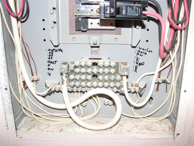

Was the panel labeled like this?
Sure beats those crappy nuisance paper legends that peel off all the time! :shock:
