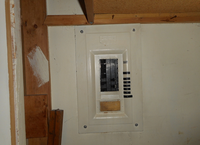

I know this isn’t safe. The glass fuses were placed behind the panel cover. They could only be seen and accessed by removing the cover.
Does anybody have a better narrative than what I posted above?

Maybe add that its the wrong cover, or is it just upside down can’t tell from the pics
Should of added, that thing needs to be in a museum.
Kenneth,
The cover is actually oriented correctly. (Cutler at the top)
So I thought the box was upside down. That wasn’t the case either.
Thanks for the reply
Looks like it was designed that way. If so, the listing agency did not have an issue with it.
