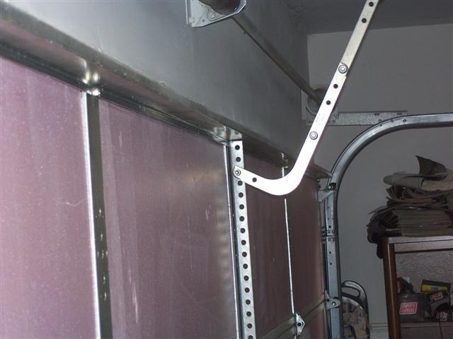

A torsion bar prevents the door from bending in half when in the open postion. It also helps to protect the door from the force of the door opener.
You are correct they are field installed, but this one was little different. I think the home owner installed it.
Why would a 2x4 not have broken it? I am weaker than a 2x4.
The first picture is the broken door. The second one is the proper installation of a door, with a torsion bar. Please note the the opener was attached directly to the thin metal door. How long would that have lasted before it broke?

Understand what you are saying now. I am just used to the panel section stiffners. You City boys are sooooooooooooooooo sofisticated in your term descriptions.
Marcel:) :slight_smile: :wink:
I fished a tournament a few weeks ago with a guy that had been doing garage doors for 30 years. I asked him what he called it. He said a torsion bar.

Here is one that failed during inspection on Tuesday.
Wow! I and other would love to know what was said and how it was handled so I can be prepaired just a little for when I do it .
Roy Cooke
An actual picture of a failure. That’s cool (having the picture, that is, not that it failed per sé).
Richard; that is pretty cool. How did you explain and write this one, out of curiosity?
