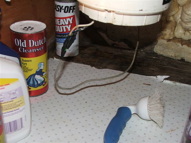

Great disposal hookup!
Originally Posted By: cbuell
I found this on yesterday’s inspection-----“functional” too! This belongs in Ripley’s Believe-it-or-not-----it is phone wire run to the unit----and it looks like they at least used two wires for each conductor.
Originally Posted By: jonofrey
Yikes! That’s a fire waiting to happen.
Inspection Nirvana!
We're NACHI. Get over it.
Originally Posted By: Greg Fretwell
The strange thing is the insulation doesn’t seem to be burned
Leave that disposal on for any length of time and I’ll bet you that wire gets hot.
They've probably just been lucky that they haven't run the thing for more than a several seconds.
Inspection Nirvana!
*** Warning , theoretical assessment, don’t try this at home kids ***
I put a pen to paper (and a calculator) to this. 24ga wire is 26.2 ohms per 1000 ft. Assuming paralleled pairs it nulls out the down and back so effective resistance is .0262 per foot. 1/2hp motor is 9.8a FLA per 430.148
When you run the numbers it comes out that you are dropping about a quarter of a volt per foot and dissipating about a watt and a third per foot. If this is only a couple feet the disposal will never notice and I doubt the wire woulds get warm to the touch in the minute or so that the disposal runs.
All that said this is still a serious safety issue that needs to be addressed.
Again the reason I prefer cord and plug connected disposals and dish washers with a receptacle properly installed for the purpose.
A home inspector might be able to deem the interior of the sink base is a wet location but a “code” inspector can’t. If you used that logic you would need bubble covers on every outlet and switching location in all the bathroom and kitchen areas. Every place that could possibly get wet in a calamity pretty much includes the whole house if you are in windstorm country.
"… Bad grounding, or no grounding."
How can you have that in "pipeland"?
As I said, a home inspector can pretty much say anything they want but a sink base is not a wet location in the NEC. The electrician you have the customer call is going to say unkind things about you if you tell them it is.
