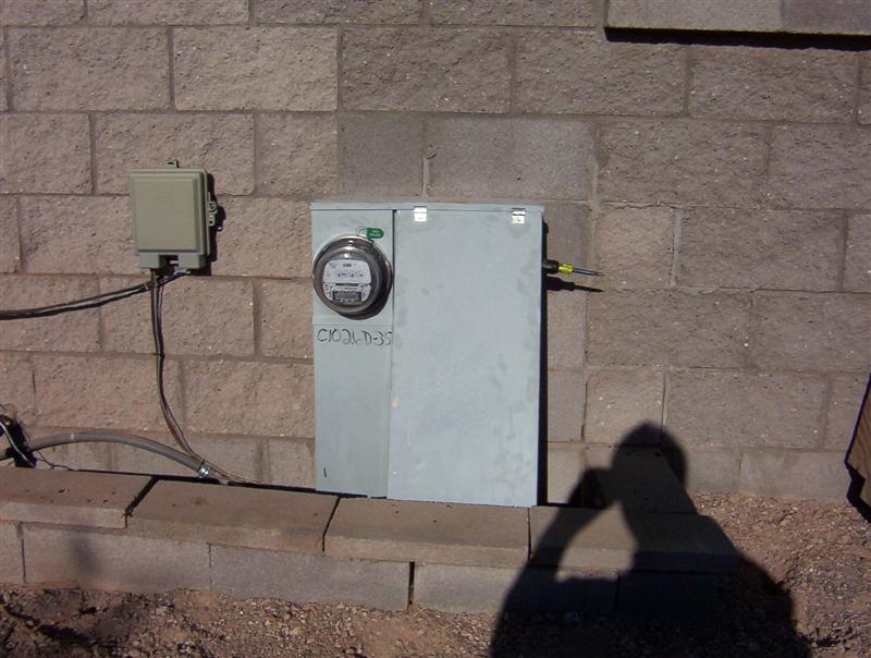

Ground clearence?
Originally Posted By: tallen
What do ya'll think?

Some body lost there screwdriver??
Originally Posted By: jpope
The meter height is generally regulated by the utility company, but it should be 44" to 66" above grade with a maximum of 75". I don’t recall any minimum height requirement.

The problem here is that the cover will not open without removing the blocks, and the water main is also in this “well” . The util. said the meter was set between 41"- 66" as all house meters they install are in this range. Sparky has to check it out anyway as it is not accessible. Can a receptical be installed at grade level?
So long as it is GFCI protected and covered, I guess so.
The water main is supposed to be a minimum of 15" from the center line of the meter.
Yea, I know.
I just think it is kind of crazy to have the possibility of that well filling up with water. If it did the bottom 4" of the panel would be under water.

Originally Posted By: bbadger
Here are the meter requirements for a power company in this area.
Quote:
A. Outdoor Meters.
Outdoor meter sockets or troughs should be mounted
so that the face of the meter is less than six (6) feet
above the final grade. In no instance will any meter be
installed with the top of the meter more than six (6) feet
nor the bottom of the meter less than three (3) feet
above the final grade. A clear area of three (3) feet is
required in front of each meter.
If you really want to get to the bottom of this find the name of the power company serving this meter. Look them up on the Internet and there is a very good chance the info will either be on the web site or down loadable.
Min. is 3’6"
The utility decided to move this meter/panel up to meet specks . I won. Thats one for me. icon_lol.gif

Originally Posted By: dbozek
What part of Ohio are you from Mike…I happen to have very good relations with the utility company up here, in northern Ohio…and in this case they would require the meter to be installed between 3’-6’. I typically set my upgraded meter bases at 5’. Perhaps that utility company have midget meter readers.
