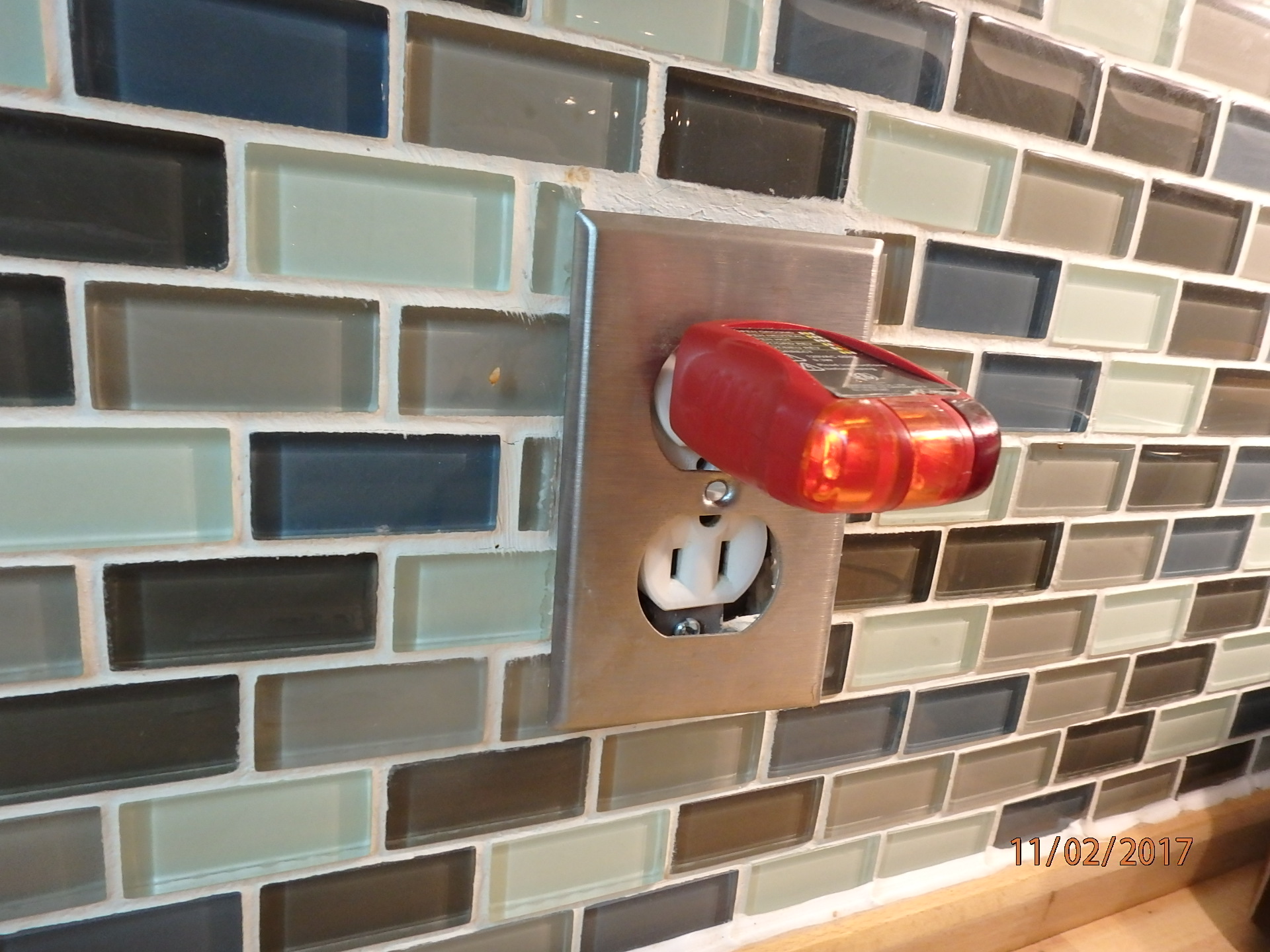

This is why ground pin on receptacles should be positioned upward. My 3 prong tester got welded to the metal plate and got a firework to boot!
Looks to me like the plate was loose or improperly installed .
The cover plate wasn’t screwed in and fell when you tested the receptacle?
Are you going to fix it?

Sounds like it, maybe the thing had no screws in it. Even with ground up it likely would have blown up unless you really think that the plate would balance on the round groudn prong.

The thing (cover plate) had no screws in and fell resulting in a firework…
Having the ground pin up would not have resulted in the firework as ground pin would have prevented contact between the neutral and live…
I borrowed a screw from the light switch nearby to fasten the receptacle, so yes. I didn’t want to leave a potential safety issue.

well if there were no screws in the cover you would think a trained inspector would have known better than to put a tester in there and would have just pushed the appropriate test button…there is a reason they mark that button test… in my opinion ground up is just a backwards orientation…
But you could have had the plate short between the hot and ground. Same end result. No defined benefit to either orientation.

I removed the screw, the cover fell and no firework…
I maintain that ground pin should be positioned upward for improved safety.

And in all scientific fairness the plate in the OP is different from the one in your test, the chance of it having two missing screws is minuscule.
