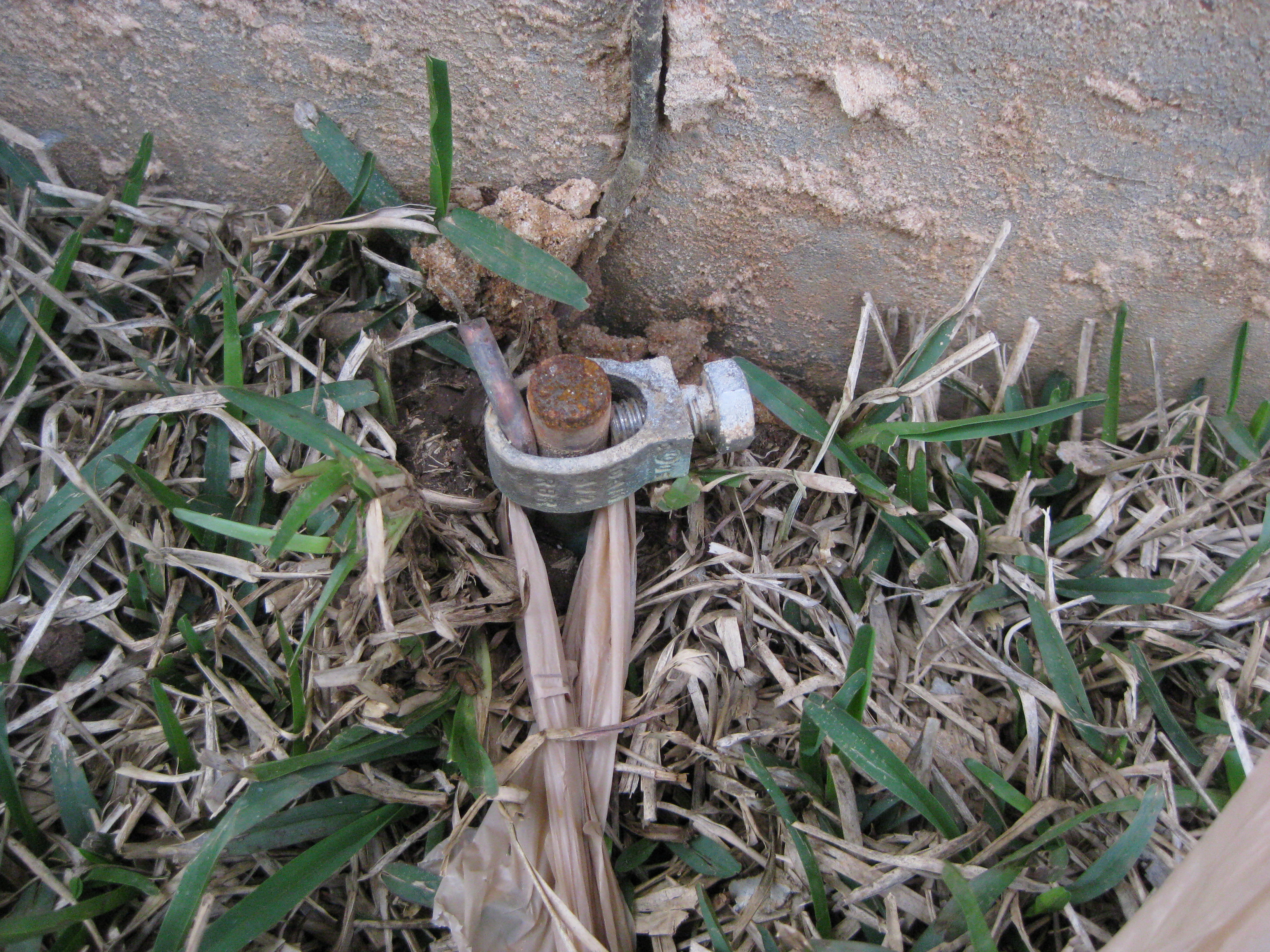

Ground Rod tied to Neutral Bus
Robert, if the green conductor by the neutral is going back to the meter, what are they doing? running parallel grounded conductors? green color? GEC on grounding bus? something smells funky. Rookie wired this thing or someone messed with it?
See below - three more photos for clarity.
The GEC not being able to terminate on the ground bus bar just seems counter-intuitive to me. What is the logic I wonder?
And that is because 250.24(A)(4) mentions a wire or busbar but NOT a screw?
Michael it does seem like the 4 wires HHNG go straight outside to the meter base directly on the other side of the wall. 1 foot run.
For a 1Ø, 120/240 volt system there should only be three conductors from the meter to the panel. As you’ve correctly stated if there are four then two are possibly in parallel which is not permitted for two different sized conductors.
Yes you’re correct, use a screw as the MBJ and the GEC’s must land on the neutral bus or somewhere upstream of that point. Change the screw to a properly sized wire type MBJ and you can land the GEC’s on the EGC bus.

*Green insulated wire next to neutral wire - goes to meter base
*Bare copper wire on ground bus - goes to ground rod
*Bare copper wire on ground bus - goes to gas meter
This is set up to be a 4 wire. Don’t know why…

Since the service raceway is PVC there is no reason for the “4th wire”. It is most likely in parallel with the neutral it would be a direct violation of 250.6(A). Also in this case a GEC cannot terminate on the EGC bus.

More than one GEC is permitted. Anything that qualifies, and is present, as the Grounding Electrode HAS to be grounded. Building steel, Ufer, Water pipe, ground rod ETC… and in some cases. (pipe, plate or rod) a supplemental must be installed. Unless they’re all next to each other, the contractor is gonna run a separate wire for each one. You cannot parallel the GEC though, aka two wires to the same electrode.
