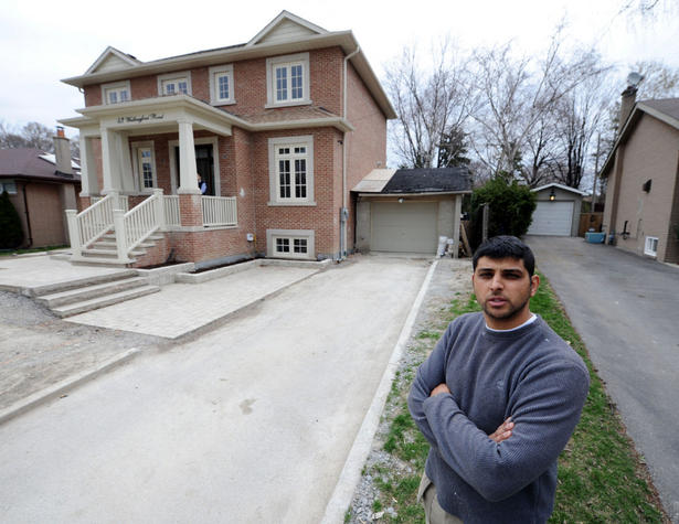

Stephanos Michelis stands in front of the north Toronto home he bought three years ago and is currently rebuilding. The garage previously attached to the original house wasn’t built to code.Michelis is suing the city, his real estate agent and the former owner.
RICK EGLINTON/TORONTO STAR

You can tell from the picture that the garage would not pass an inspection who needs the Inspector to even come.

If you look at the before pictures (via Google Streetview) and the one above, it appears that garage was damaged extensively during the house construction.
