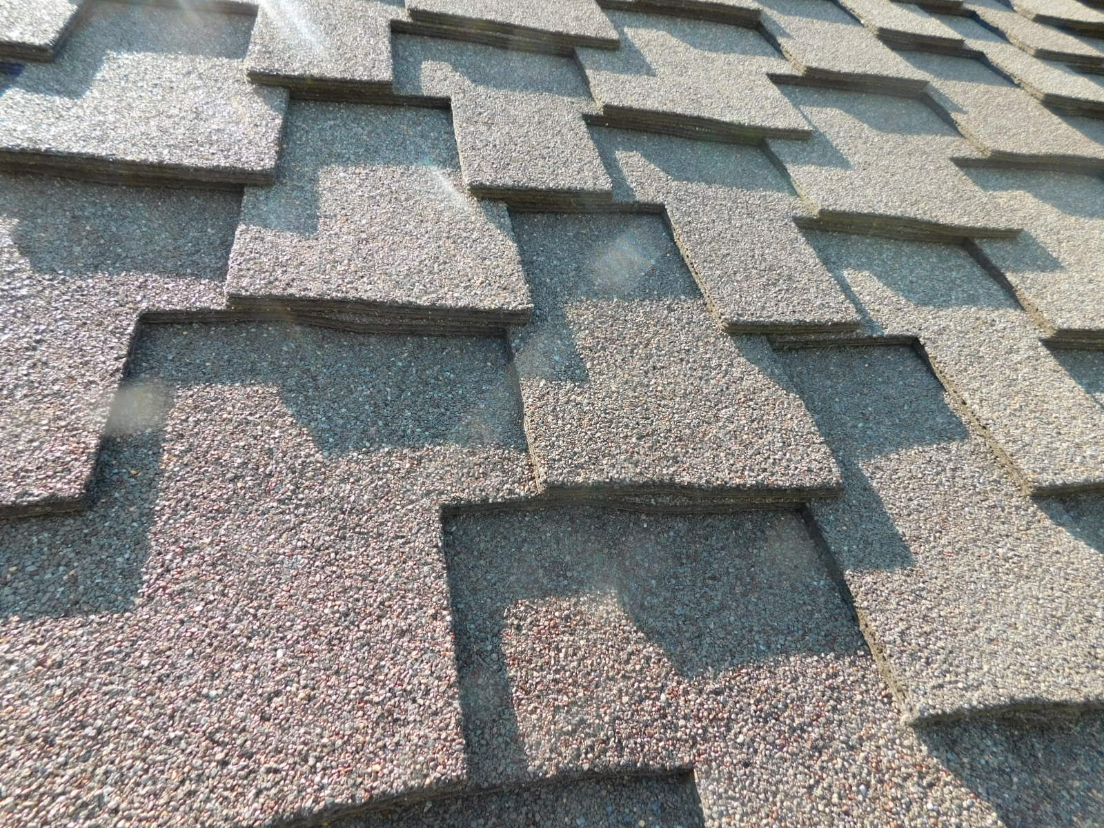

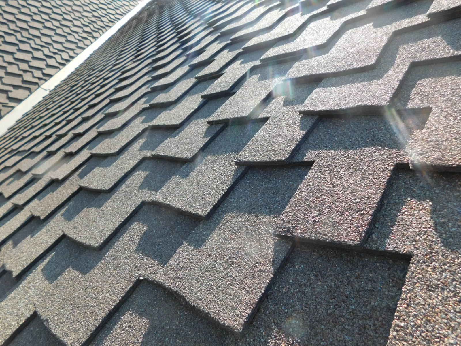

Have any of you hammer techs any knowledge of this type of shingle. I have never seen any in this area until yesterday. They were at least a 1/4 inch thick
Not a hammer tech but I have seen those.
Thick and heavy as hell.
Presidential Solaris
Certainteed
http://www.certainteed.com/products/roofing/Residential/luxury/341257
355 lbs. per square
The Owens Corning Product is even heavier at 465 lbs.
Thanks guys they are made by several MFG Mr Google gave some good links the shingle is actually called triple layer shingles and most have a 50 year MFG guarantee
That’s a lot of weight per square. Hope the trusses were designed for it.
A square is 100 square feet, so they weigh less than 5 lbs per sq ft. Asphalt shingles weigh about 2 PsF and are approved for up to 3 layers (although a really cheesy practice). I don’t think there’s any concern with the roof structure. I have no clue what structure design is in Cali, but in my area trusses are designed to withstand 62psf load.
