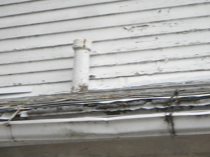

Has anyone seen this?
I found a vent stack in an 1898 house. Aside from not extending above the roof line, it appears to have some form of a vented capped. There were slots cut into the threads. Can anyone enlighten me about this configuration?
was there a oil tank?
looks like a whistle
No oil tank, just this protrusion through the rear porch roof in direct alignment with basement vent stack. I haven’t run into this type of termination before. I’m wondering if it will ever be able to provide enough air to follow the drains when the house is running at full bore.
It should not be closer than 12 inches from the wall.
Bet that was a dormer built after the vent was in place.

Bob is on the right track. I find turn of the century homes had the vents on the exterior of the home and most did not terminate above the roof.
