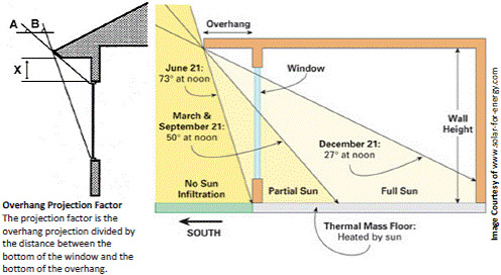

The pitched roof on the south side was observed with apparent attention to optimal overhang principles for solar efficiency. This condition is indicative of high performance construction practice and assures passive solar heat gains in the winter and resistance to unwanted heat gains in the summer. Some minor detailing may be improved for enhanced efficiency. A qualified specialist is suggested, e.g. licensed energy assessor/contractor for further recommendations if desired.
