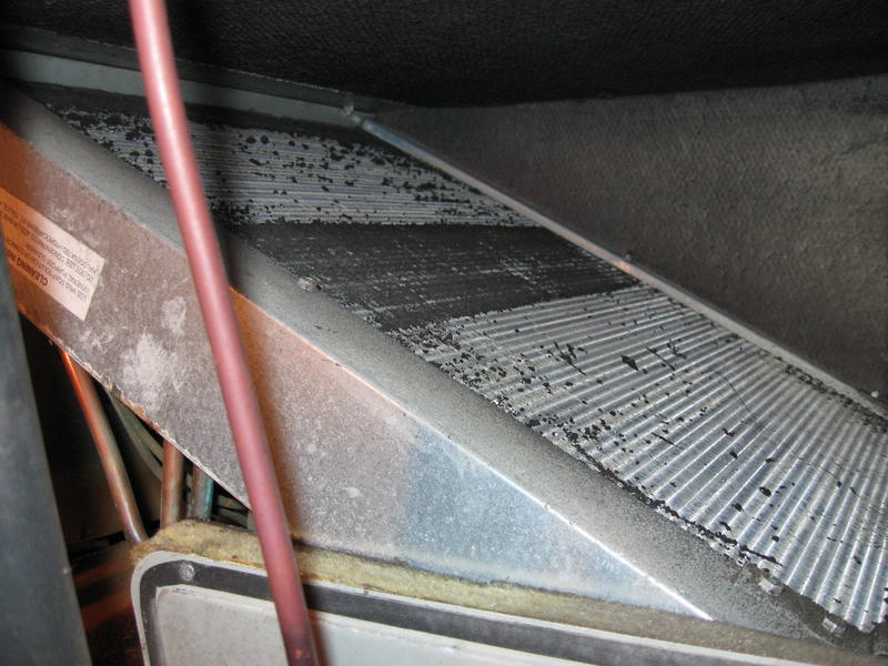

Ok, I think I’ve discovered the problem for the lack of performance, but I could be wrong. It is a bit embarrassing, especially since it is my own house that this has happened to. Over the last couple seasons of use, my second floor heat pump had been giving me problems, so I’ve had it apart several times. My second floor heat pump has never had a filter installed at the air handler, only at a return in the ceiling. Typically, this is what I see when I inspect a home around here, that is, in one place or the other, but not both. I know I had checked both air handlers for a filter when I moved here and saw nothing in the filter compartment on either one of them. My first floor heat pump has 3 each 14 x 14 x1 filters in dead space beneath the stairwell. Anyhow, to my surprise when I pulled the side panel from the first floor air handler this morning I found an old empty Dr. Pepper can and a filter that had been sucked in and partially laying on top of the evaporator coil (which would explain the odd smell we had when we first turned it on, but didn’t smell like DSS).
I’m attaching some images for some follow up questions. First, is it acceptable to have a filter at both locations? Second, I have not experience at cleaning one of these things, so is this something easy to do? If so, how is it done? Or, should I hire someone to come in and clean the entire system?

Just vacuum, the coil , shine a light through it. Lol it happens shoemaker kids go barefoot
I’m a firm believer in complete maintenance by a licensed technician at least once a year to check coil condition, refrigerant pressure, etc. As far as the filter, just one good one is all you need.
