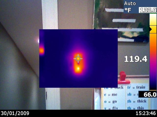

Does anyone know were I can find out about what the acceptable limits of the safe operational temp of a Dimmer switch?
The picture below was one I found today, It was working 6 lights at 40 watts each.
Thanks
Michael Ruffing C.M.I
Foresight Home Inspection Inc
Yes I just addressed that in todays report.
I called Leviton and was told they are operational to 190 degrees.
They are rated from 600 or 1000 watts.
This holds true for the brand I was researching called Lutron.
Hope this helps.
P.S mine had 10 spots in canned lighting and was up around 110 degrees.
Robert
Thanks, That just what I was looking for.
