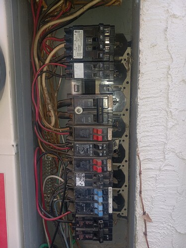

HELP me check what's wrong (if anything)
Hi I am studying thru the program to become a CPI here in so cal. I am trying to apply what I am learning around my house (built in '84) and decided to take the panel off. Electrical is my weakness, admittedly. Can ya’ll take a look and tell me what you’re eyes are seeing as good or defects?

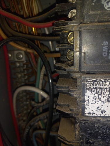

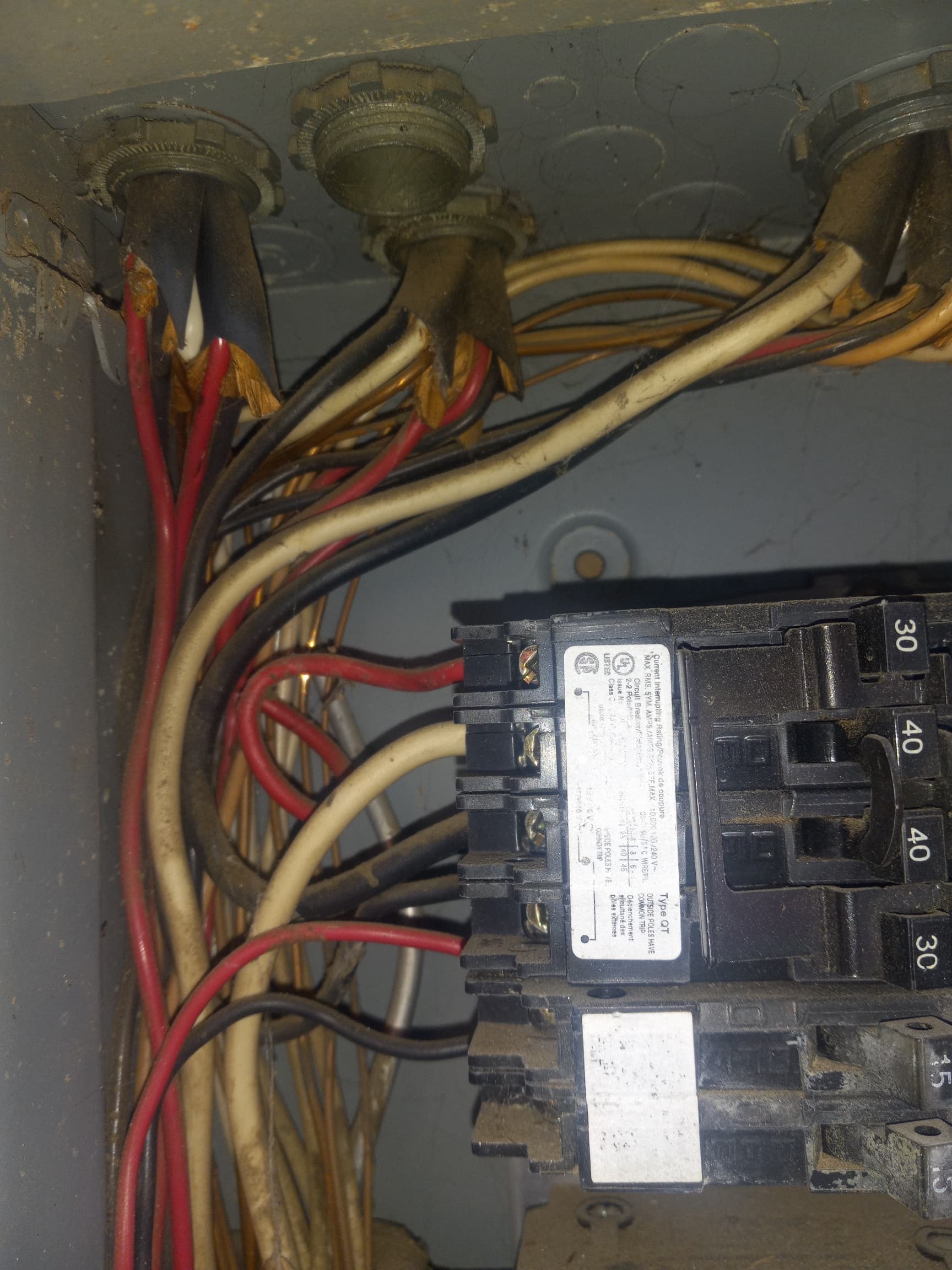

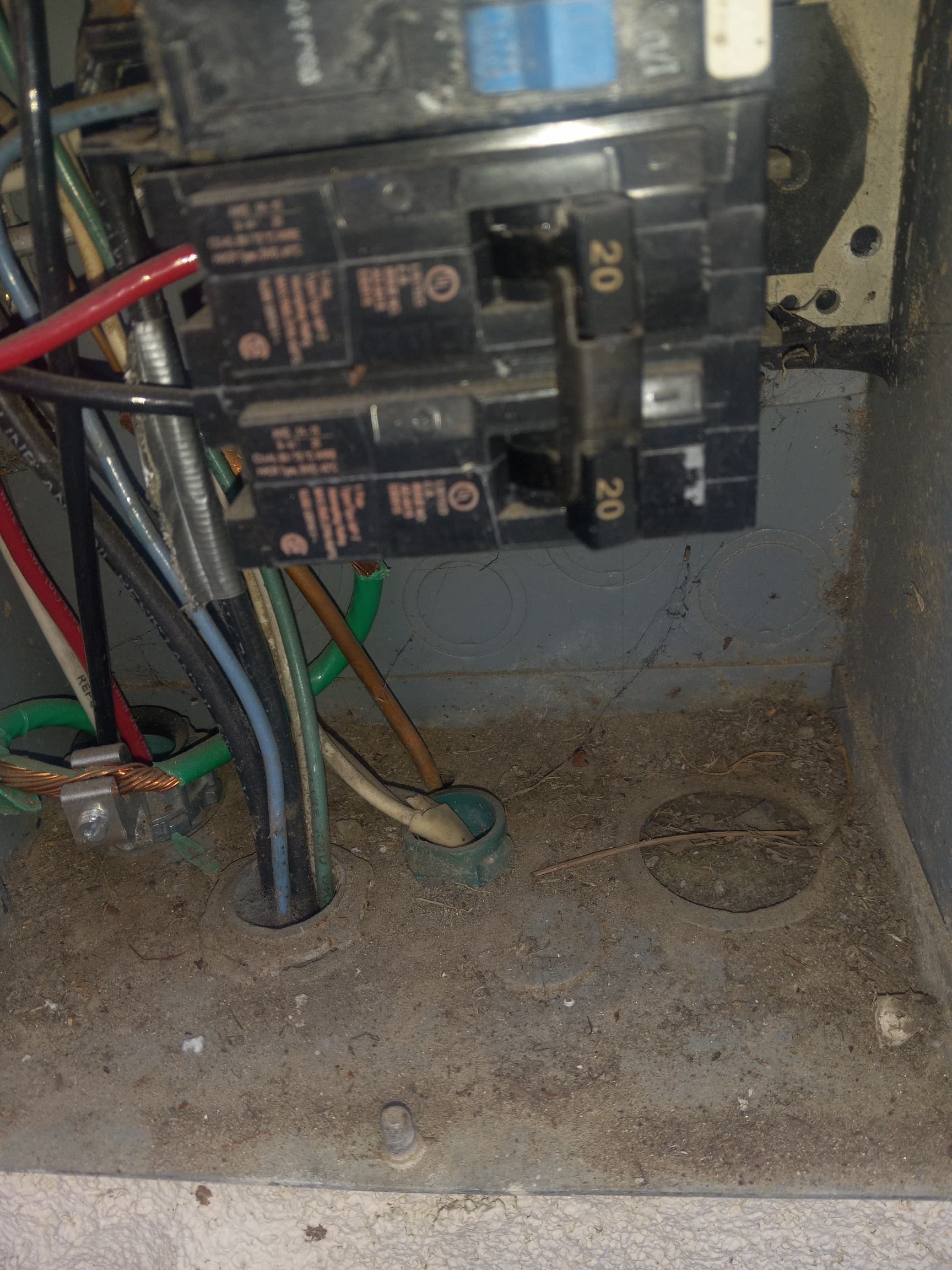

Not completely thru the electrical portion but really confused because I also have solar in my home so not sure if thats tied into this box. But off the back I see tons of dust and dirt which I “think” would be dangerous defect. I see some open wires coming at the service entrance (not sure if they should completely insulated). Not sure which are the 3-wire service cable. Don’t see signs of double tapping. no signs of arching from what i can tell.

Welcome Joe. Thanks for posting your pictures and questions. There are some guys here that know a ton about electrical inspections. They want you to do a little homework first though. I’ll give you a few pointers and you can investigate further and let us know what you find.
I see you have quite a variety of brands of breakers in that panel. This can be a sign of many electrical upgrades or repairs over the years. Seems like a lot for a 1984 home.
Westinghouse, Bryant, Cutler Hammer, Siemens, and some I can’t make out.
You may want to check if all of these different breakers are compatible with the panel model that you have.
Did you check to see if any were a poor fit? I mean were any breakers loose?
Was the panel labeled correctly? I often find that when different breakers are installed, the legend is not updated correctly.
Did you check that the proper branch wire size was used for each breaker?
Did you trip any breakers? Did you listen for any buzzing sound? Did you take a thermal picture to look for unexpected temperatures?
Did you look at the neutral and ground wires to check if they were terminated properly? (I don’t see them clearly in your pictures)
What’s up with that green wire at the bottom of the panel with the torn insulation? Does that look right to you?
Let us know what you think and we will chime in with some guidance.
To assist you with that… review one photo at a time, and looking at the photo that you posted (only), tell us what you see. Looking at the entire system when you are (limited) experienced, will just overwhelm and confuse you.
Also note… all we are able to see is what is actually shown in your photos. You have the knowledge of the entire (visible) system. Keep that in mind when taking your photos.
IMO, an inspector should take two photos of most “concerns”… one as a close in for detail of the concern, and two an overview shot of the general area for reference. Obviously, some concerns will need more than two photos for full understanding of the situation.
