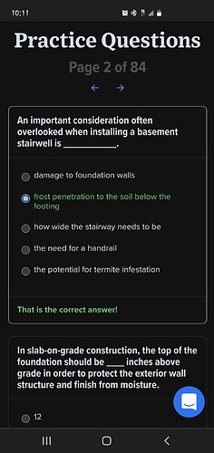

Help understanding this answer
Can someone please tell me where this answer is in the training materials, and/or explain to me why this is the right choice?
Thanks in advance.
Greg H.
Note: Assumption is being made that the stairwell is exterior due to the concern with the Frost Line.
Key word here is… ‘Overlooked’.
All other answers are basic and obvious.
To assist with your understanding…
I live in an area of Minnesota where the “Frost Line” is near 6 ft (65-72 inches).
Frost line definition is measured “below grade”.
A basement stairwell is no longer “below grade” and is now exposed to the elements, thus the frost line is below the stairwell, NOT the original grade.

Are we not looking for broke or damaged stuff. Are safety issues not a priority?
What is frost about? Something that may cause a significant issue? Like a “damaged wall” which is one of the answers.

But also, it appears you are in a “foundation” section of the course (based on the next question) which is another clue.
Assuming it was interior is where I was wrong.
