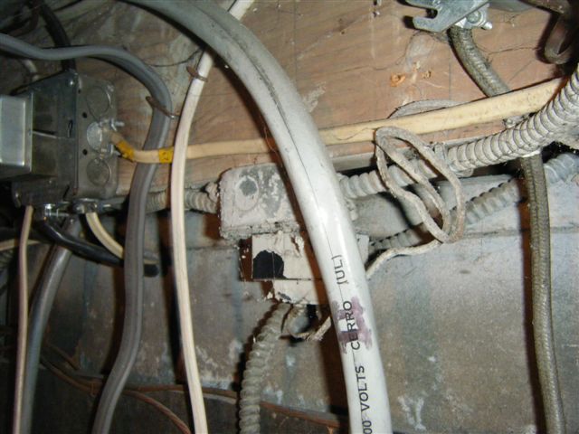

Help with strange color floor joists
Can anyone determine what this could be? and how would you write up this flue if at all.
There are also 3 3" Natural Gas water heaters connected to the flue.
The Octapus Furnaces have been converted to coal. and there are three flues from them tied into the flue.

  1. No chimney cap.
  2. Furnace flues improperly entering unlined chimney. Need proper seal/connection.
  3. ? Bunch of dirty wires?
  4. Very dirty basement?
  5. Anyone seen Dr. Seuss?
  6. Recommend Level II chimney inspection
  7. Water heater flue should enter chimney above the furnace flues.
And that is likely asbestos on the ducks of the gravity furnaces.
Funny the title of the thread has no bearing on the questions possed :wink:
The strange color of the joists appears to be a Lime wash, which is common in those old basements.

But its pealing and washes off
Probably and old white wash then Ricky
Regards
Gerry
Its a new one on me also. My bigest concern was that the old furnaces might be causing it. Or caused it in the past before they were converted to NG
On very old houses. Turn of 19th century they would sometimes start a fire in the basement to kill off termites. Now that is site you don’t soon forget.

The white wash is a good indication of fire damage.
