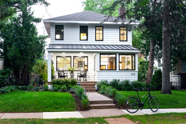

Anybody notice that their $700000 2019 house is missing handrails and guardrails? Very picturesque, though.

Here if I remember correctly railing is only required if the floor surface is 30" or more above grade.

30 inches is correct. This looks really close to the 30 but, of course, I can’t know for sure.

I count four risers. A handrail is required even if is is less than a 30" height to the porch or deck.

I was referring to the porch height to grade.

Yes, if each of the 4 risers is the 7.5 inch they’re supposed to be… 30 inches!

On his webinar today, Ben G. Said that he calls out steps for lack of a handrail even if it is just one or two steps. He says that he is guided by safety concerns, not by minimum code.
