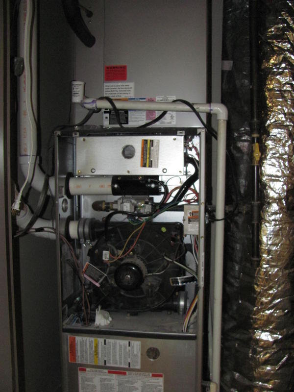

Is the high efficiency vent supposed to have a drain at the bottom elbow or is it okay for it to drain through to the bottom of the inducer unit? This was a Carrier. Thanks.

No problem with that. It is common to drain them at the bottom of the induction fan and several other locations as well.
Yes the only thing to look for is repairs at the connection. Sometimes you get lucky and find a patch job with a rust spot underneath the induction fan.
Let is run for awhile to make sure it is draining properly.
