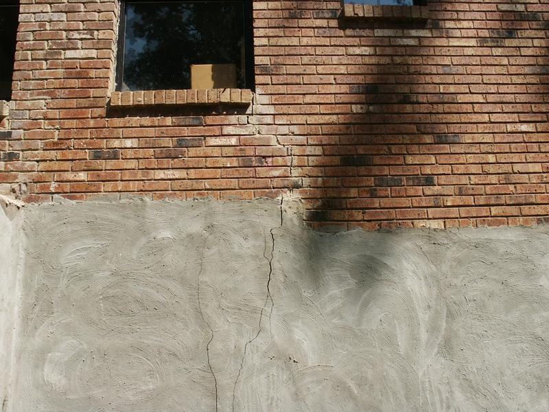

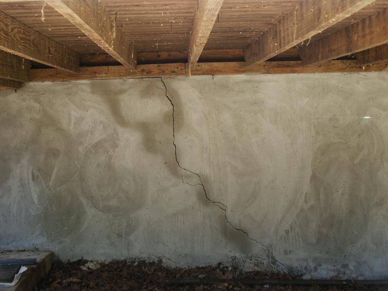

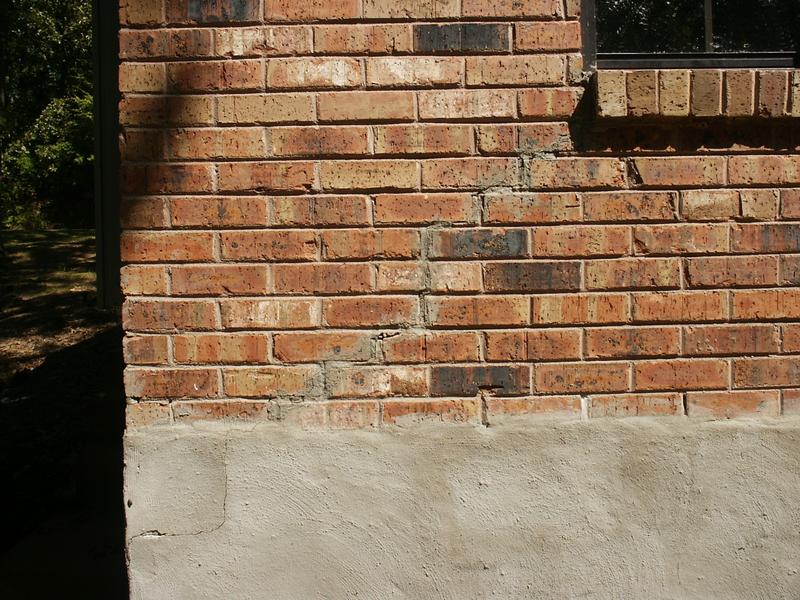

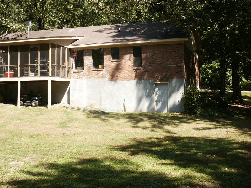

Hello,
I was wondering if someone could help me. I just bought a house, built in 1983. I love the house, but I see it did have some cracks that looked bad through the mortar of the bricks. Before I bought the house, I hired a structural engineer to determine if the house structure was ok. He told me everything was fine. He tested the soil and gave me the ok and said this was normal house setting. When I was in closing that engineer statement did not want to be liable for anything he wrote on paper. I thought that was odd, but figured it was his standard procedure. I am writing to you with pictures of the cracks, to see what other opinions maybe. I have attached pictures of the cracks. Ps, the house is on a hill and I have small cracks in the drywall, but doesn’t match with the cracks on the outside.
 ![crack1.jpg](https://global.discourse-cdn.com/internachi/original/3X/2/8/28abbafabaaed81a8bb66d9fe945005f5509d095.jpeg)
 ![back_view1.jpg](https://global.discourse-cdn.com/internachi/original/3X/6/3/63b0e3b838d193499d1ca95150915382931223cc.jpeg)
 ![other_sidecorner.jpg](https://global.discourse-cdn.com/internachi/original/3X/5/3/538824a7e36e474d542865f1faa9aeb555c63040.jpeg)
 ![crack2.jpg](https://global.discourse-cdn.com/internachi/original/3X/5/3/531cf7b99ca28e0b197ad8e1c60945ce78940d14.jpeg)

Patrick,
What state do you live in? Does the ground freeze? It’s not possible to say with any certainty what is or isn’t happening from photos. From what I do see you should install gutters and get the water away from the foundation. The crack in the basement appears to be wider at the top but that only tells me that something either heaved or settled.
I would recommend you have a qualifed mason repair the cracks, install gutters, check for tree roots in the area remove any trees that could be causing the problem… And see if the cracks reappear if they do something is still moving.

Patrick, like Mark said, are you in a frost prone area of the Country?
There is a lot of exposed foundation on the lower side of the house and wondering how much of a frost wall there is in the ground that might be the culprit for the cracks.
If not the frost, it would definitly be some differential movement caused by settlement.
I noticed that there is a heavy parge coat on the outside and inside of that foundation and wondering if that was not done to hide more cracks that have not since moved.
Who ever did the parge coat, was a little sloppy around the edges at the brick. 😉
The cracks in the foundation and the brick where it was repointed are signs that it has been there for a while, so it could be possible that these cracks occurred in its early stage and hasn’t moved since.
Monitoring the cracks for awhile would tell you if something is still moving.
If not, then you can prepare for some remedial work to fix it.
Good luck.
Marcel :)😃

Thank you for the replies…
I live in Northern Mississippi (Hernando). I do have some trees in the front and back, that I thought about cutting down. When it rains, I notice the water runs around the house down the hill to the lake, which is about an 1/2 acre away. On the side of the house there are no cracks in the brick, just in the back where you see them. I did notice that there is erosion that washed away some of the soil that exposes the cement patio underneath. If I monitor the cracks, how long should I do it, and how much does it have to move, before it could be considered dangerous?
The windows and doors shut good, so I didn’t think there was too much of a problem, but i am worried that one day the windows will just break or crack.
The previous owners hired the builders to renovate the house and they did a half %$# job.
