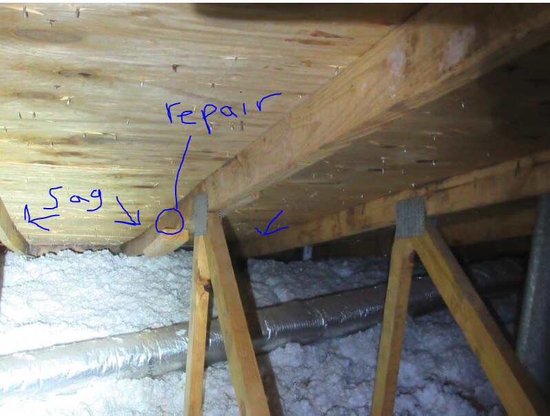

I just inspected a home and called out truss rafter sagging. Is there an acceptable tolerance for some sagging or deflection?
Here is the photo, though it is always hard to “catch” sagging in a photo.
I don’t think anyone is disagreeing with this Randy. However the OP’s question appears to be about the board above the bottom cord. Would you agree that this is a non issue?
If you look closely at the photo there are two bottom chord members connected with metal truss plates. This could be the bottom chord on an attic truss or some other reason this bottom chord was carrying a heavy load.
