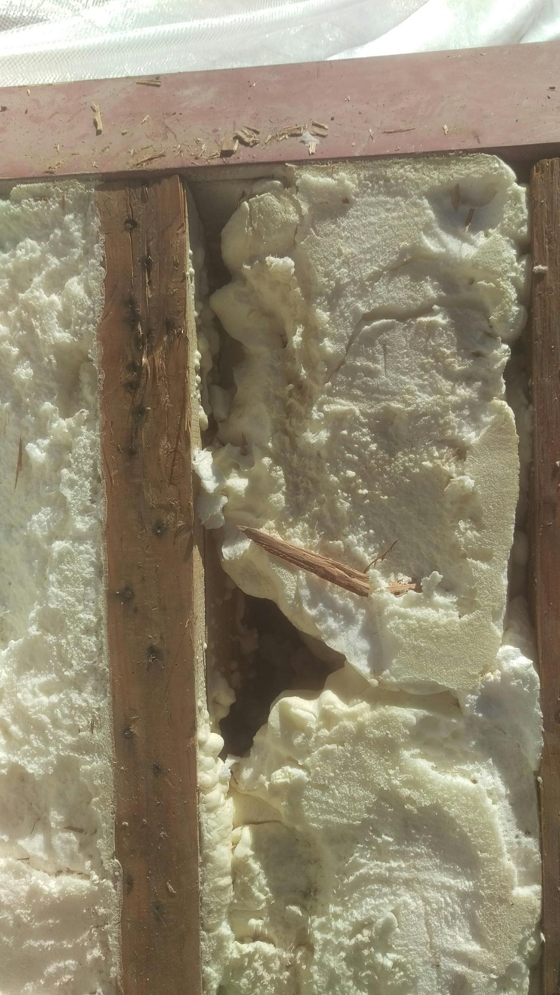

This photo is taken from the exterior of a roof insulation repair job. The original foam insulation was not properly applied, and so did not fill the entire cavity of this particular bay. There is a full gap evident between the exterior roof decking and the interior sheet rock of the vaulted lid.
Air leakage will occur around the location of this gap where there is no air-tight sealant between the interior and exterior of the dwelling. It would present itself primarily along the seams of the sheet rock, such as at the peak of the vaulted lid line, and show up as a dark spot on an infrared camera, given the cooler climate of SW Montana.
There is also potential for radiant heat loss, given the lack of insulation material.
A proper repair for this problem would involve filling the gap completely with closed-cell poly urethane foam insulation.

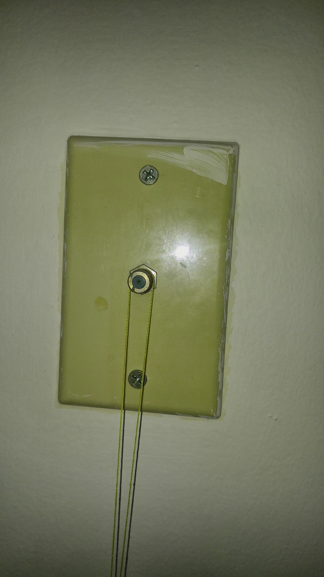

The cable face plate is installed correctly. There appear to be no air gaps. Thus it is sealed correctly.

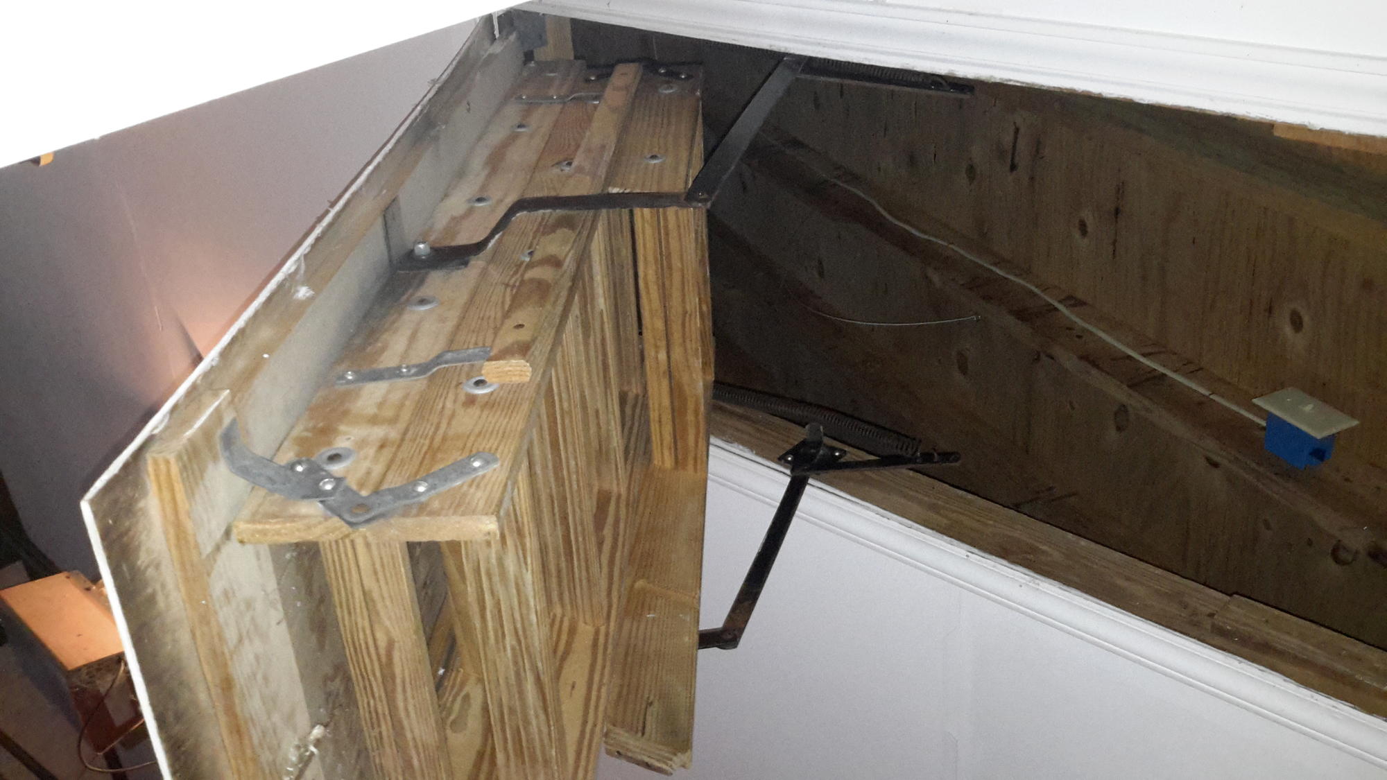

This is an image of a pull down attic stair unit that is not insulated or sealed. I would recommend sealing the unit and providing insulation.

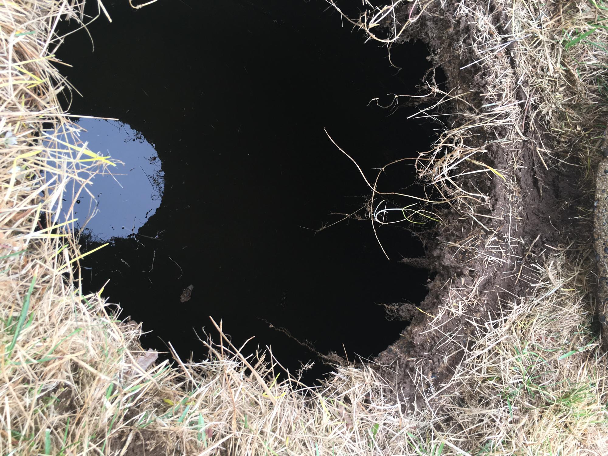

the first item on my re-inspection report was the septic. During original inspection it was noted the tank was below operating level before the start of the inspection. Indicating a possible leak. Upon re-inspection it appears the tank is again below operation level. Further evaluation by a qualified septic company is needed as this could signify a crack in the tank.
