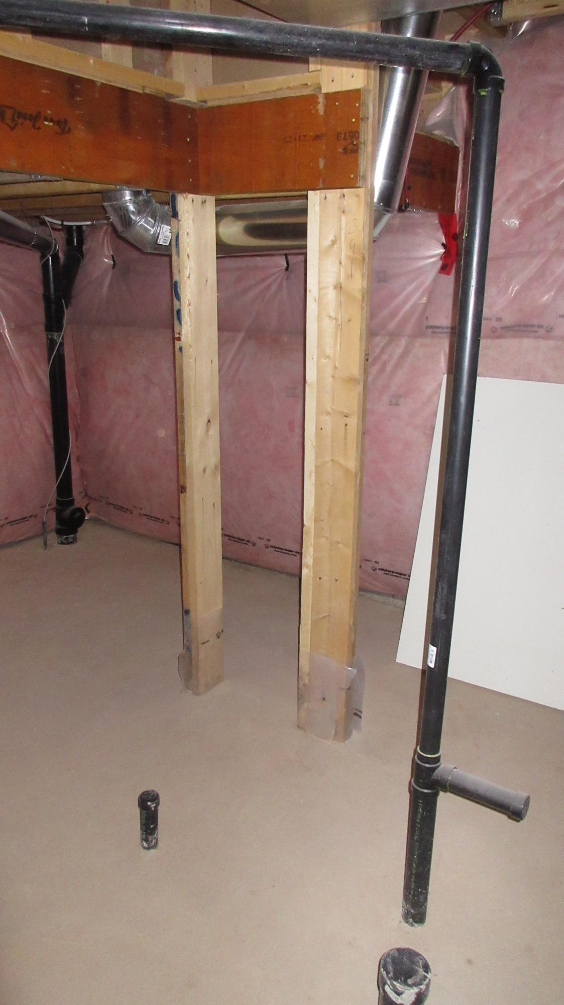

I am seeing too many cases of homes in the 30-day and 1-year warranty periods of the TARION warranty where a simple PDI performed by a qualified Home Inspector could have saved the buyers from a lot of aggravation in dealing with the Builder/TARION Warranty corporation after the home has closed.
For example this, to the untrained looks OK.
After closer inspection, it appears the Builder has used sleight of hand to avoid doing the job properly.
This was systematic on every wooden column in the home, and the same in at least 5 other homes in the sub-division. All homes were completed since November 2016.
Now the owners have to sit on a TARION claim to wait to get things fixed.

If might be. I don’t know about other jurisdictions in Canada, but in Ontario, since 2012 there has been a requirement to have hard-wired smoke alarms/detectors in every bedroom.
And wood columns (first post) need to have a membrane between the wood and the cement.
The builder had installed a “sock” around the foot of the columns, which when slid up exposed the missing membrane. At least one column was already showing signs of water wick. House is 7 months old!
