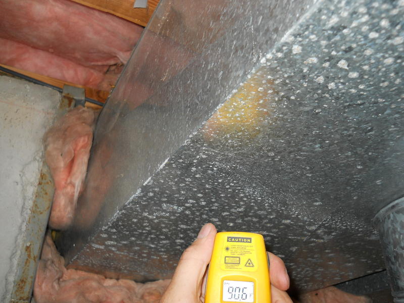

Noticed a duct/plenum in the basement (aprrox. 20’ away from furnace) that was too hot to touch. Never noticed before, of course I don’t usually touch them all either. I just happened to “lean” on this one to look at something else. Anyway, is this normal? What would cause temperature rise (heat exchanger problem?)? The thermostat was set at 80 to test furnace.

Air temp in the duct can be as much as 130 or higher with furnace operating if the space the duct is located in is conditioned the duct is not required to be insulated. If the space is not conditioned most rectangular duct is insulated to the inside. My guess is your duct is not insulated and would feel hot to the touch. The furnace has a high temp limit switch that would shut the burner down if it was operating properly

90.6° is too hot to touch?
My thermometer is old & cheap and may not be 100% accurate, however, yes, it was hot enough that I couldn’t keep my hand on it very long. Just doesn’t seem right.

Sorry Mike I did not see the temp in the pic he has no problem its imaginary Josh you should Hug a duct more often

Friction has absolutely nothing to do with it … you probably couldn’t even measure the increase with standard measuring devises. A standard efficiency furnace may have a temperature rise at the equipment of between 80°F - 90[FONT=Verdana]°F (data plates usually say anywhere between 70[FONT=Verdana]°F - 100[FONT=Verdana]°F rise)[/FONT]. If you had say 65°F return air, the supply at the furnace discharge would be around 135[FONT=Verdana]°F - 155[FONT=Verdana]°F. So even 20 feet away may feel too hot to touch … ;-)[/FONT][/FONT][/FONT][/FONT]

That duct is not 90, look at the material you are testing.
No emissivity adjustment, high reflection. You may be measuring the inside of the meter at that range.
Maybe a Fluke 570 series thermometer is in order. You can set the emissivity on those. :stuck_out_tongue:
A roll of tape is cheaper. :wink:
