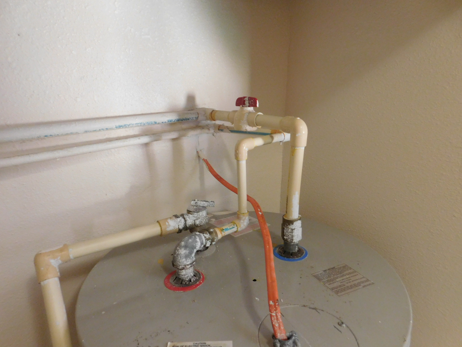

Lets try this again.
While doing an inspection on an older home rehabbed by investor I noticed low water pressure on hot side at all faucets. When looking at HWT the dia of the hot supply was too small. A plumber went to home and confirmed this. Not to mention other issues like the exposed romex.
 ![DSCN6606.JPG](https://global.discourse-cdn.com/internachi/original/3X/c/8/c879c8c8cb7d33fb727b3aaf7b3b66c65ee68f2e.jpeg)

> [@smilek](#):
> While doing an inspection on an older home rehabbed by investor I noticed low water flow on hot side at all faucets. When looking at HWT the dia of the hot supply was too small. A plumber went to home and confirmed this. Not to mention other issues like the exposed romex.
The pressure would measure the same the flow would be restricted with a smaller pipe . This is a common mistake made all of us some times .

Yes…flow. Your right! Wrong description on my part.

Where is the PR valve?

It that pvc and not cpvc on the hot line?
