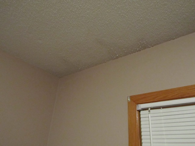

Inspection & Writing Assignment:
The attached photo shows signs of moisture intrusion from a part of a home system above the ceiling interior. Staining on the interior of the ceiling material indicates there has been a past or is a current leak. This is a surface clue that something is a deficiency in the house system and leads an inspector to search for a possible cause beyond the surface. In this case the attic is the next component of the house (as a system) that can be inspected in attempting diagnosis of the failure.
