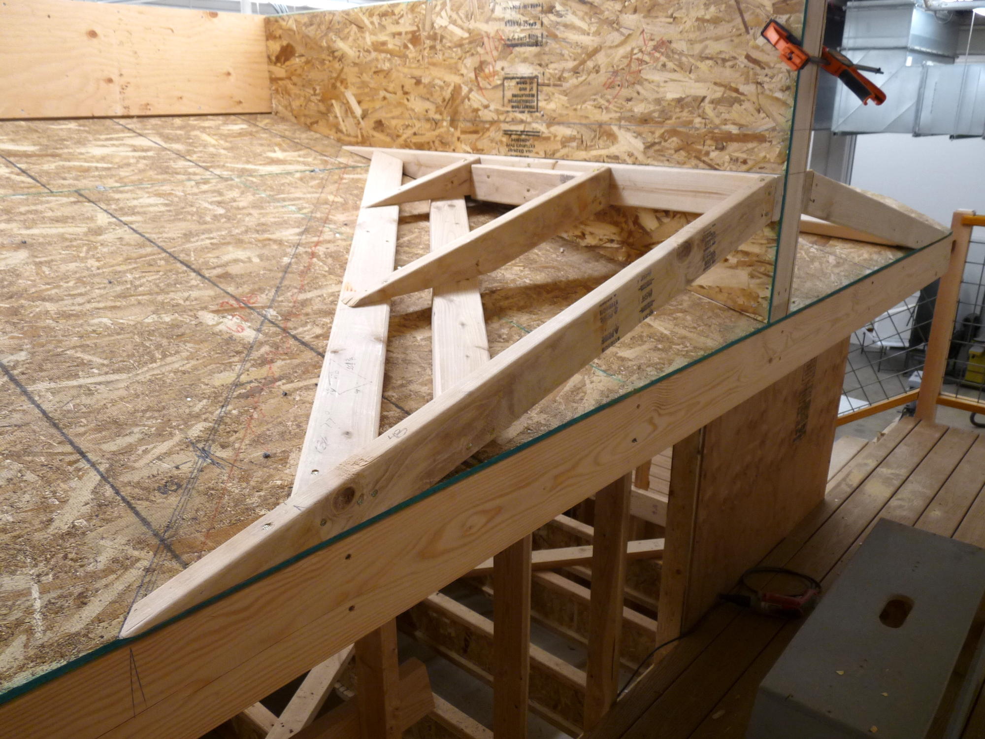

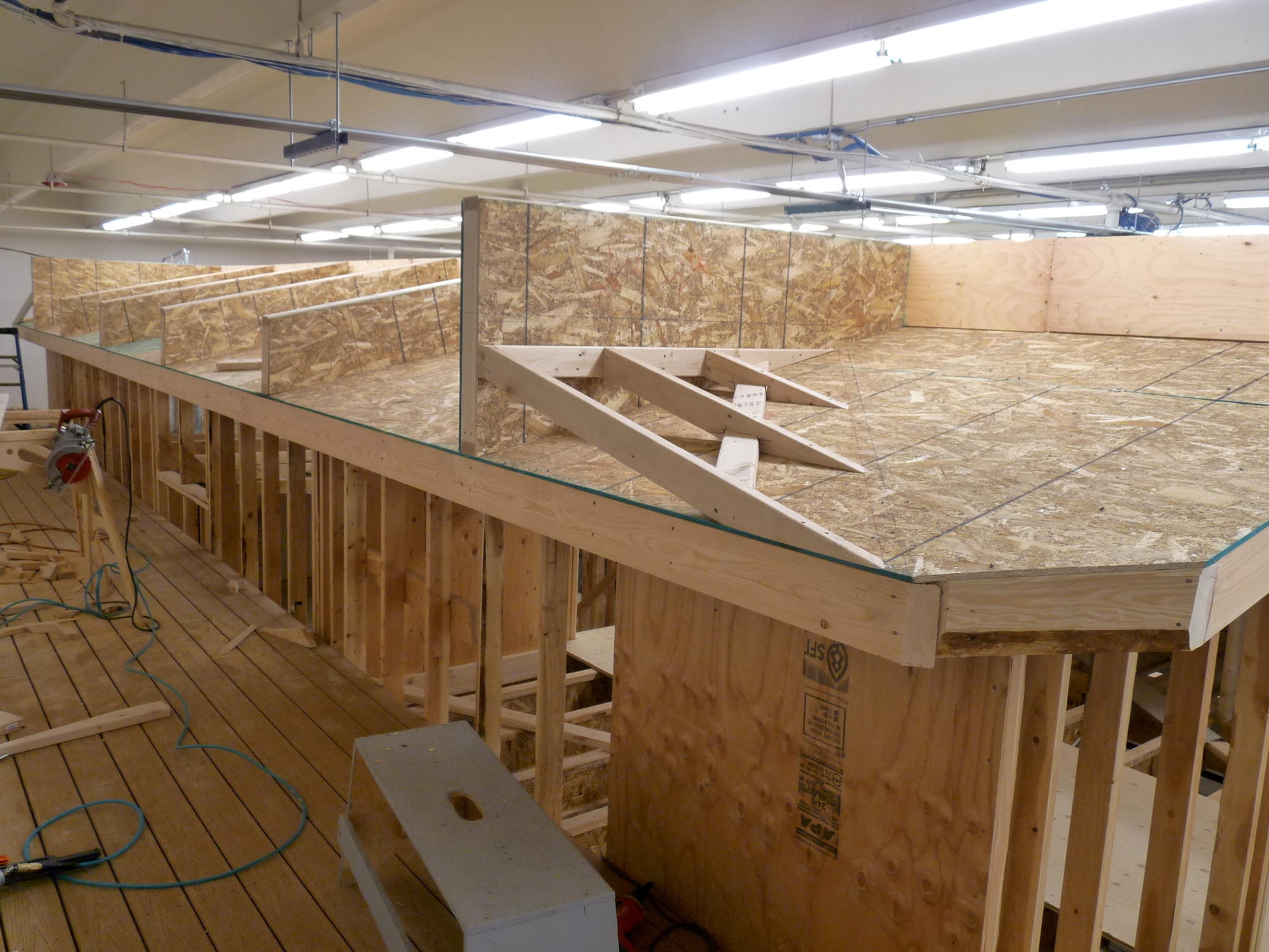

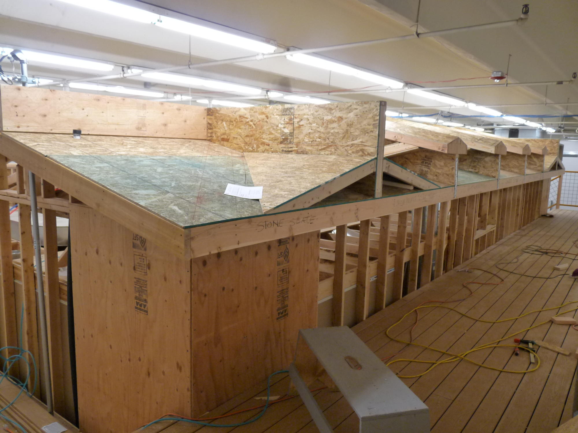

Shot from the elevated walkway of the House of Horrors. The station separation walls for different roof-covering materials have been framed and the valleys are under construction.

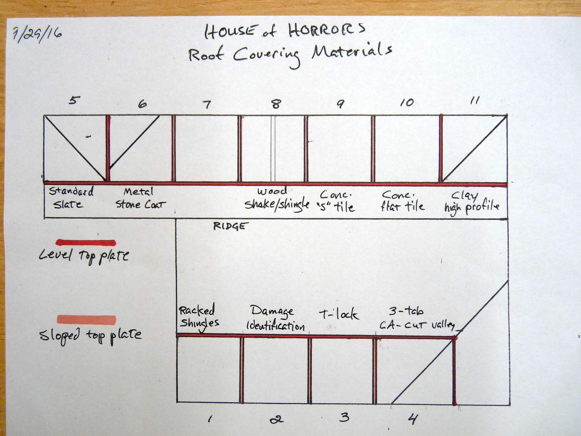

There’ve been a few changes since this plan was drawn up. You’re looking at the valleys in the upper left corner of the drawing.

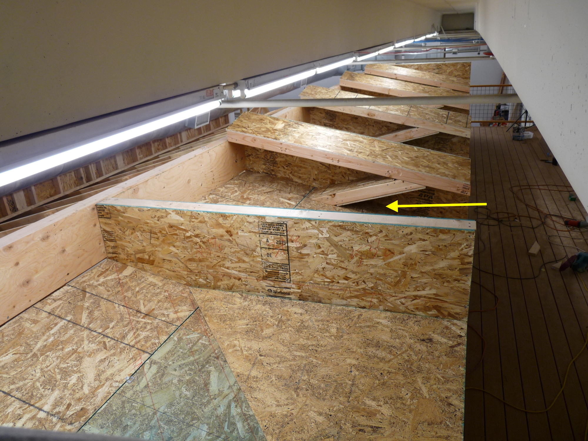

Framing of the roof stations. The little roofs on the station separator walls allow us to show ridge/hip conditions, and the little return roofs allow us to show flashing details and roof covering material fastening details for the areas where the two roofs meet (yellow arrow).
This is especially important for units that are fastened at their tops like tile and slate. If the tops are cut to keep the butts aligned, how are they then fastened? Most of us have seen tiles slipping in areas like this.
The small return roofs are just tacked into place at this time. We’ll want to place them appropriately for the different roof-covering materials so that we make our point clearly.
Yes, I still need to install crickets.

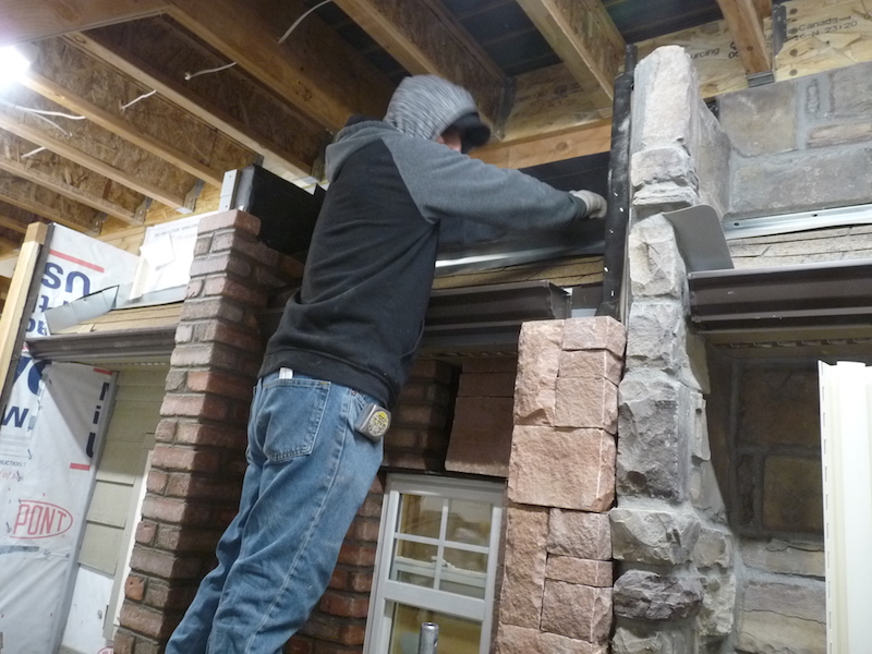

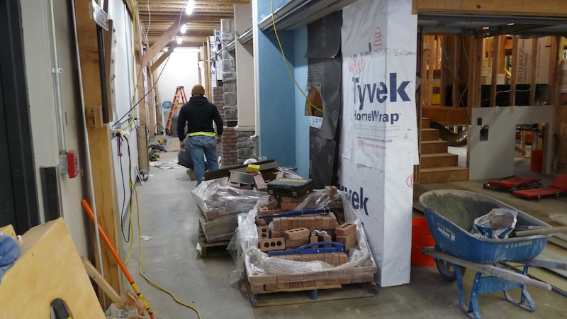

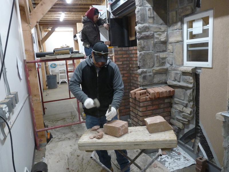

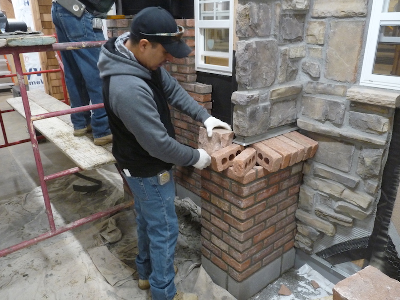

The weather has finally gotten cold enough to get some contractors in here to do exterior wall claddings. Masons are going strong on brick and dry-stack stone, and the siding guys are getting through FP lap and shiplap siding, cedar Channel Rustic, vinyl, and Hardiplank.
We’ve finally got some guys who are good. The first siding guy did such a poor job on the Hardiplank that it wasn’t even good enough for the House of Horrors!
It’s hard to find people when the economy is going strong and everyone is busy.

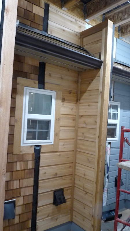

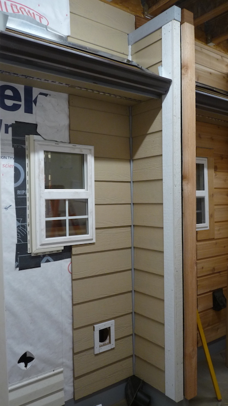

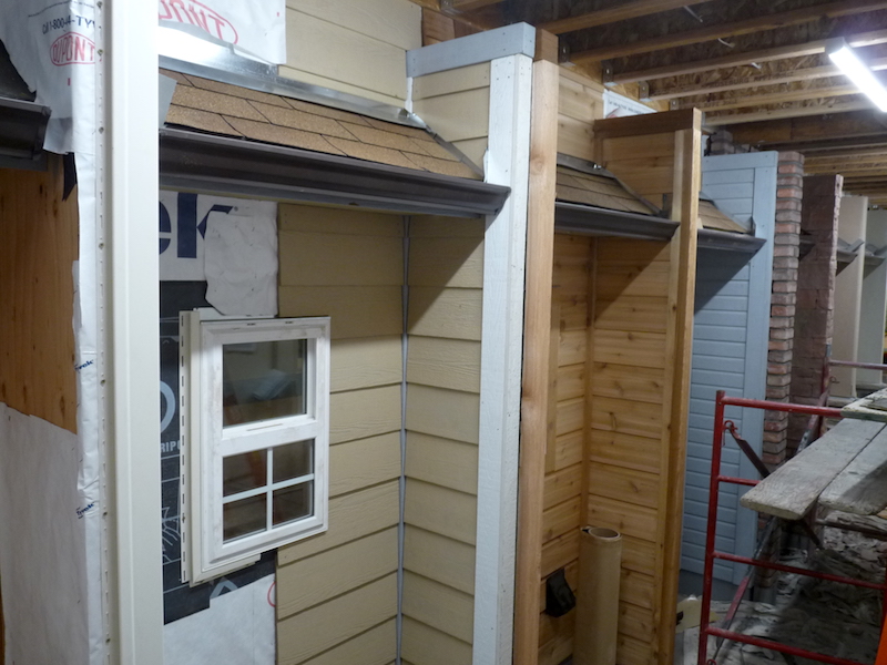

Siding installation. Finishing it tomorrow with the completion of vinyl and Hardiplank. Inspector Street is taking on a whole new look and feel and it’s exciting to feel like we’re finally closing in on the major portion of the work.
