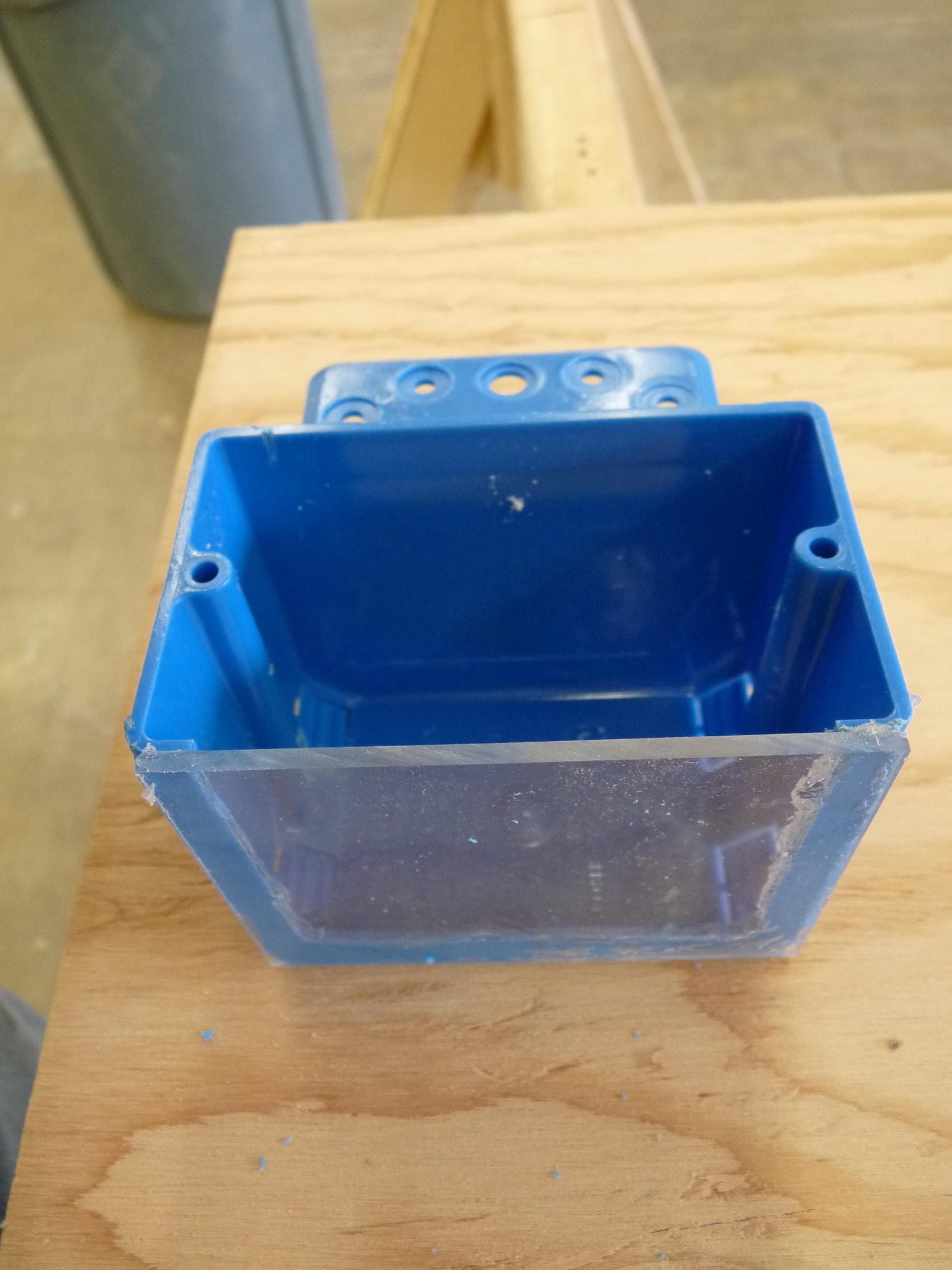

What kind of boxes will you be using to house the receptacles?
Mostly blue plastic from home depot but we’re open to suggestions.
Roy, you mean the tie bar between the two neutral screws on the outlet, right?
with one side cut out and covered with plexiglass so the wiring is visible. The boxes will have LED lights inside and will be hinged to swivel out for easier viewing.
This is the first one. The rest I might cut out the backs instead.
I asked about the boxes because a plastic box should fool the tester when connected reverse ground/neutral. Also a reverse hot/ground connection with a metal box that’s ungrounded will energized the entire box.
I think maybe we’ll avoid that last one.
