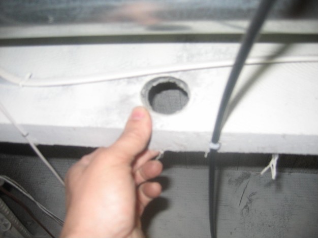

How about when found in purlin support?
There is almost 1" deflection on this roof.
Hasn’t failed YET (you’re eligible too)

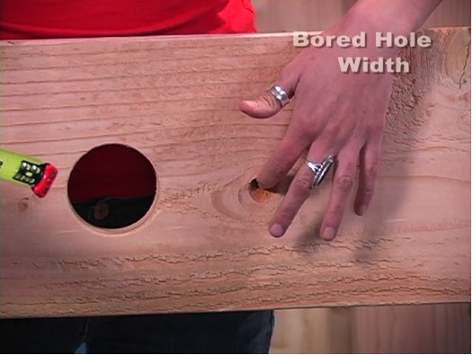

Paige goes over holes in studs (bearing and non-bearing).
** Q: You’re at an inspection, and a non-load-bearing 2x4 stud has a bored hole in it. Its diameter is 1 and 3/4". Is it a defect?**
http://www.nachi.tv/ppv/5

Which way is the hole bored through 2x side or 4x side? :mrgreen:
I know the answer to this and my own purlin question, just another pic from last week, timely, imo.
I hope anything I sent was or will be of use. I may have to take the plunge just to find out the “real answer”

Paige demonstrates according to the previous definitions… a “sound pin knot” located near a “check.”
:slight_smile: thanks for the definitions - i wish i had them before shooting http://www.nachi.tv/ppv/5
May I ask for your input on the next nachi.tv video? We are shooting a master plumber with 2 hot water tanks on Thursday.
actually i took the liberty to make the knots in the video look bad with a drill bit. :wink:

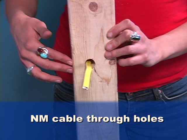

the min. edge distance on that cheat sheet changes when a nm cable passes through
miss paige demonstrating
