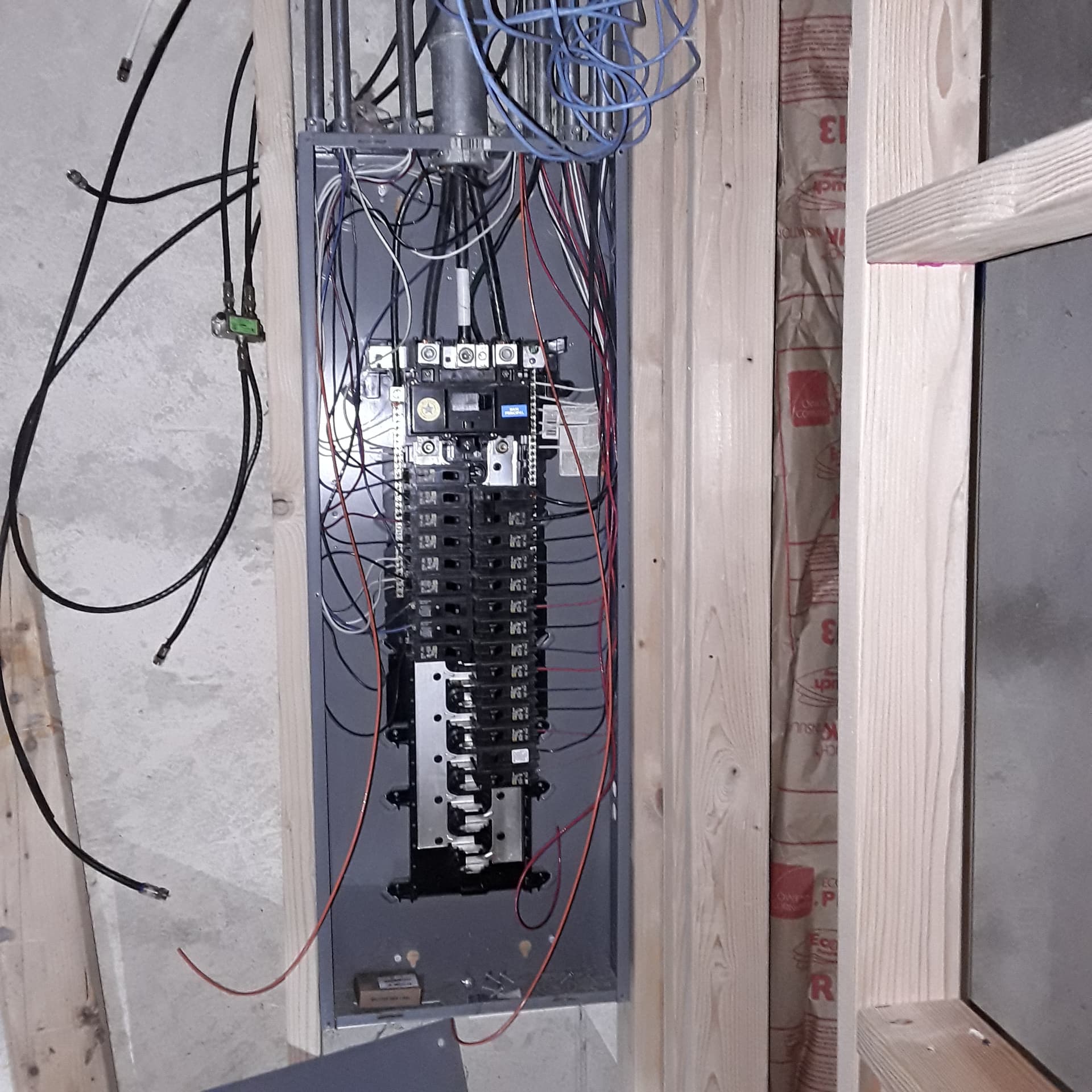

20170629_150813
Unless the owners make it easy and its already off.
Now that is freaking scary!! :face_with_peeking_eye:
