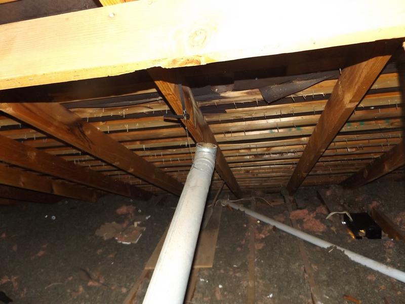

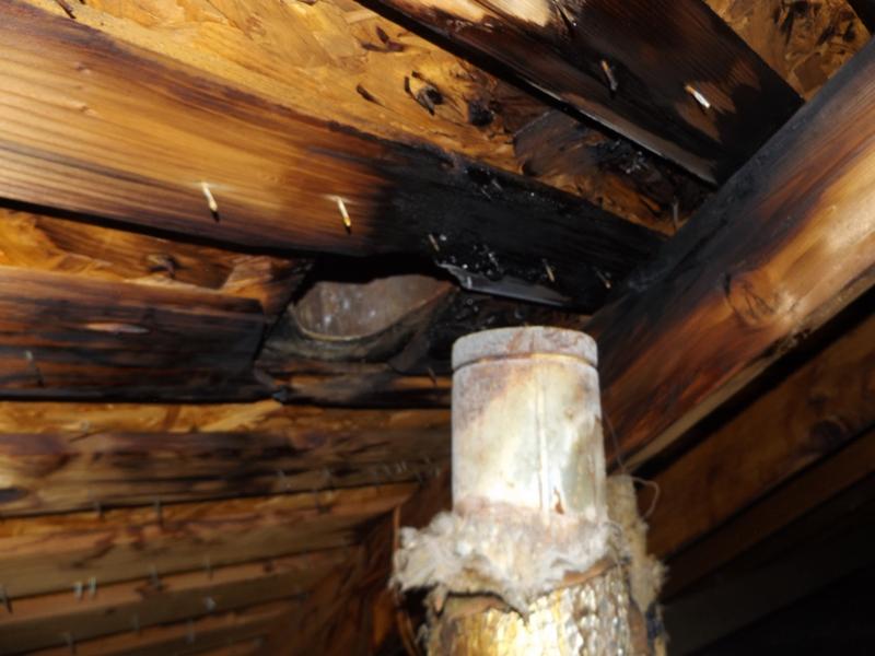

Furnace installed in 2011 I guess no one ever checks the flue pipe. Double wall class B vent can never start fire according to some thought patterns :shock:. They even insulated it to make sure it lost no heat in the attic. If this roof had been a 4X12 she probably would have ignited

Good catch Brother you may have saved a life.
That’s the find of the week for sure!

Thank God you had caught that. The situation could have been far worse for sure. Nice job!
